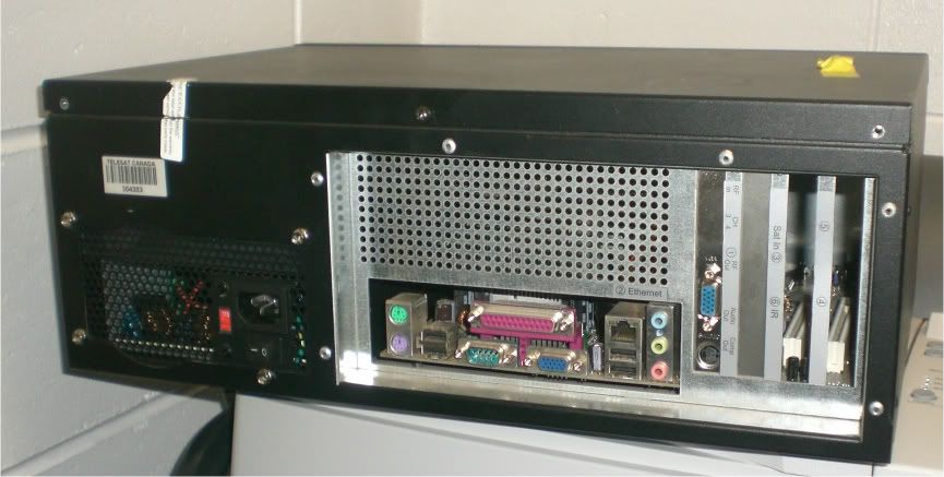

A while back someone was asking about converting a pre-PC-hardware Buck Hunter to Pro. They wanted a look inside a dedicated Pro or later to get an idea of how the computer is wired up. Well, I just happened to be poking around in Badger's dedicated Pro so I took some pictures.
The power supply died on this computer. A standard ATX power supply drops right in from an electrical standpoint, but doesn't physically fit inside the case. My solution is to leave the PSU sitting loose inside the cabinet and run the wires through the hole, as seen here.
The connections are, left to right: I/O comm (serial), VGA video out, security dongle, audio out...
..and the connector on the far right is interesting. Insetad of including a power supply in the cabinet, PlayMechanix opted to leech power from the PC's power supply. That is, this connector provides DC power to the cabinet, not the other way around. The pinout, top to bottom:
+12V
GND
Reset (more on this later)
+5V
GND
And the I/O board this all connects to:
Clockwise from the right: Audio in from PC, Serial comm with PC, Guns 1&2, Video out to monitor, Video in from PC, and Edge connector for everything else
The I/O board has a watchdog that connects to the reset wire on the PC power connector. If the game goes out to lunch, it puts a signal on this wire that makes a special board inside the PC short out the reset button header on the motherboard, resetting the whole system.
The edge connector has power in, ground, speaker, start button lamp control, the start button switches themselves, the reset signal, and the coin door stuff -- volume +, volume -, service, test, coin meters, coin switches, DBV pulse, and on and on.
Pretty sure the video signal is VGA. Dedicated machines have a Wells-Gardner multisync in them (either a D9400 variant or a D9800 depending on production run, ours has a D9410) so I'm not 100% sure.
If you buy the PC and the I/O board you should be able to drop the game into any cabinet you'd like if you can figure out the edge connector. If someone actually wants to do this, I can probably figure out that pinout for them.

I'll try re-wiring the watchdog reset cable see if that does anything, but the version of software is 1.07, Raw Thrills says it is older but to go ahead and try it and call back if there is something wrong. I'm using the on board video, no expansion because none of them ever came with video cards. I know how these things are wired as I've repaired one before.
Re-wiring the watchdog reset cable produced the same results. Fans are on but not video. Shut off the computer, remove the watchdog cable, turned it back on and I get video and bios. This mobo and psu are both new and were ordered from Raw Thrills, including the I/O board......so it doesn't make a lick of sense to me. Either the software is too old, or the hard drive is the issue. I'm just waiting to call them tomorrow when their offices are open.
reset output is probably bad from the I/O board or its not wired right in the cabinet. No big deal, it really isnt needed. Your game doesnt have the USB mini fuse board does it?

Well I'm pulling the watch dog cable from the mobo, not the molex connector. My I/O board is getting power, and I do not have that mini fuse block like some of them do.
The version of the game is 1.07 BBHP, not world. The serial number for the dongle matches the recovery disc. My hope that the I/O board is wired correctly because it is a direct replacement with that jamma edge connector. This one is installed on the cabinet wall and not the metal plate that some of them have with the mini fuse block.
Its running on a microtel, we had found this cabinet stripped of its monitor, I/O board but not the computer. The original hard drive burned up, and we found a drive we could use to run the recovery disc on, but to tell you the truth I'm not the one who had originally talked to Raw Thrills about this installing on another hard drive. The Hard drive could be un-original and missing some specific files, but I wouldn't know why Raw Thrills would tell my co-worker he could run it on that drive. Why I want to personally talk to them myself tomorrow.
Oh, confirmed this is a refurbished blank hard drive that we have run the recovery disc on. So I'm pretty sure its not going to budge if it doesn't have an original.
OK, so BBHP is up to version 1.25. You mentioned a new mobo so I bet thats your problem, the new board isnt supported by old software. Linux is typically very flexible but not when it comes to video drivers. I'd start there (1.25 can be downloaded from RT's website).
I've been able to install BBHP on anything from a 20gig drive all the way up to 200gig's. So long as the drive jumpers are set right you should be good up to 2 terrabytes (not that you would want to wast a drive of that size on the game).
Something just clicked in my head. On your I/O board theres a chip that will say something about its version number. I seem to recall some games having problems with version 9 boards but worked fine with version 10 and higher boards. That might have been Safari though.
Ok, so I'll try to make a new recovery media when I get home tonight. Computers at work suck and I wouldn't be able to burn or move it to a USB drive easily. We got a 40 gig Western Digital which isn't far off from the original 20 gig version they had in there before. Yeah, I imagine now that the software this had previously ran would not be compatible with the newer mobo. The older mobo was a MCP6P M2+ver: 6.1, the new mobo is a Biostar N685+.
The I/O board, says version 10 BB Pro, I made sure to order the right version when I had previously talked to Raw Thrills parts department. Hopefully all should go well tomorrow when I get back to it tomorrow with the newer version of recovery media.

On the flipside, it's a perfectly normal PC, which makes things a lot easier.
@riki...
First part of your problem. The watch dog reset connector is probably backwards on the mobo. Flip it and I bet the CPU will boot just fine.
That connector can be BACKWARDS!? That. Explains. A LOT. I need to give our Drifts a once-over now...
Second part. Are you using on board video or an expansion card? If the expansion card isn't supported by the game (a lot are NOT) then the game will do EXACTLY what yours is doing. What version of the game is it and what revision software are you trying to load.
That makes sense... if the boot checks work but X fails it'd do pretty much that yes.
Raw Thrills/PlayMechanix PC-based games are stored in their entirety on the recovery disc(s) -- it doesn't matter what's already on the HDD; they overwrite EVERYTHING and start fresh. They'll work with literally any functional standards-compliant IDE drive that's big enough. 8GB is usually more than enough. You could install it to an IDE SSD if you're feeling wasteful.
The deal with the watchdog reset connector is actually very simple. Its a two pin plug that can be turned 180 and plugged in. One side is grounded (via the cabling the game) and the other side is the signal from the I/O board. If the grounded side is applied to the reset pin on the mobo the PC will power up but will never POST because it thinks that some one is holding the reset button on the face of the case. If your games come up then its in the right position.
