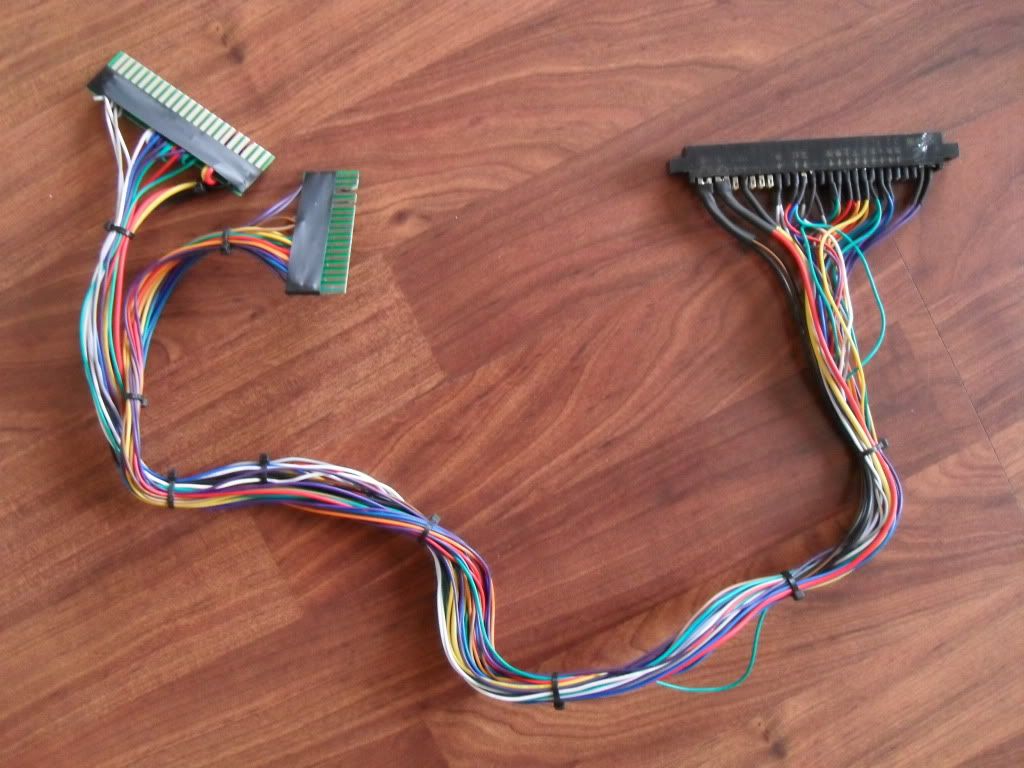

Now you need one of these:
Plug your jamma boards into your red tent
Full story here
Dang, thats cool. I wonder if he would make more?
Wow, that is pretty awesome. Perfect solution for the purist who doesn't want to hack up their original wiring and such. I need to figure out how to build that harness and run some 4P konami action in my tent every once and a while. :)
Looks like he just hacked the jamma ext harness that jammaboards.com sells. Wouldn't be too tough to make. Just remove the 28/56 jamma fingerboard and add 1 22/44 and 1 18/36. The pinouts are available for both jamma and Ninty vs. online. Instead of waiting for someone else to do it, just get to building.
