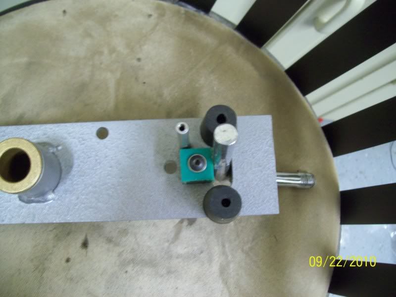

looking great - as always! but here's a question: what about the durability of that material you've used? the problem with those old control panels was that the plastic got worn out around the shifter holes pretty fast!
The wearing of the plastic panel had nothing to do with the material that was used, it was the shitty design in the stick assembly that caused the shift rod pin to bend which then led to the (even shittier designed) shift rod to pivot too much and rub on the plastic. There's only one thing that will keep the same thing from happening and my rebuilt stick assemblies have a little mod performed that looks like this.
The green block you see is a very hard plastic that acts as a guide for the shift lever. There are also a couple bushings between the roll pin stanchions that also help keep the lever from rocking back and forth.
