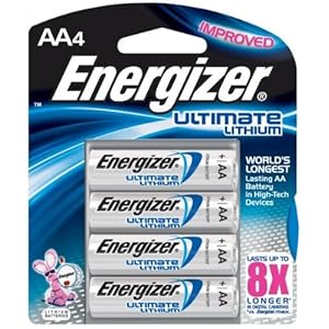

(5) About battery holders: It seems that all the cool people are removing the OEM battery holder and installing a lithium coin-cell holder. I've got a couple with the battery holder still in-tact and uncorroded. I'd rather not yank off a perfectly good battery holder, so I'm thinking of just installing Lithium AA batteries. Any down-side to this I'm not thinking of?

All AA batteries will outgas slightly. It is the outgassing that corrrodes the boards.
I'm referring to lithium AA batteries, like this:
Are these somehow chemically different from coin-cell lithiums like this?
Never looked into the chemistry, but the mechanical process of sealing the batteries is much better in the button cells. They are designed for electronic circuits. The AA cells are larger and present more potential for one oof the seams to split.
I used to use the same AA batteries until I went to replace them in one of my games and found that one has split and corroded the battery holder and there was some corrosion on the nearest chips.
Now I put CR2032 cell holders in all of my boards.
ken
