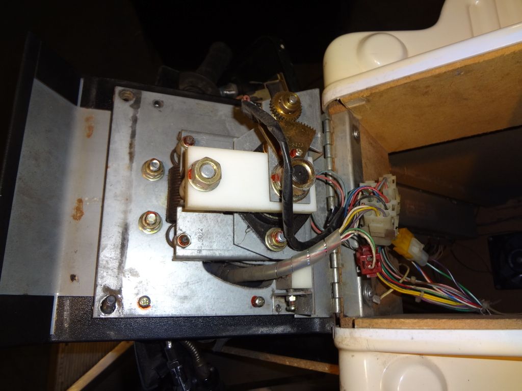

OK, so I am still a bit confused. I took the Turbo assembly off the bars and swung the bar assembly open. I am apparently missing some stuff. I also have no idea how to get wires inside this turbo button assembly and where they would even hook up if I could get them in:
Woah! You sure are missing stuff. I will take some photos of mine tonight.
If you use a flat blade screwdriver the square red turbo button will pop out.
Excellent, That's what I needed to know. Now to see where it hooks up into the harness and how the wires are routed into the game. I assume there is conduit used?
