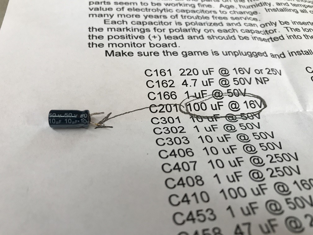

i de-solder C201, i look at the values on the cap and they don't match the specs on the info sheet for the supposed appropriate cap
the cap kit i have is for a "Sanyo 20-EZV (R-B, C)" what am i missing here?

I am working on one of them right now. Does your sheet not tell you that C201 has been upgraded per Sanyo service bulletin from a 10uf to a 100uf?

i have only seen my cap kits that have the upgrade and EXPLAIN it so the user knows what's up. i see threads about this pop up all time because other vendors don't explain it.

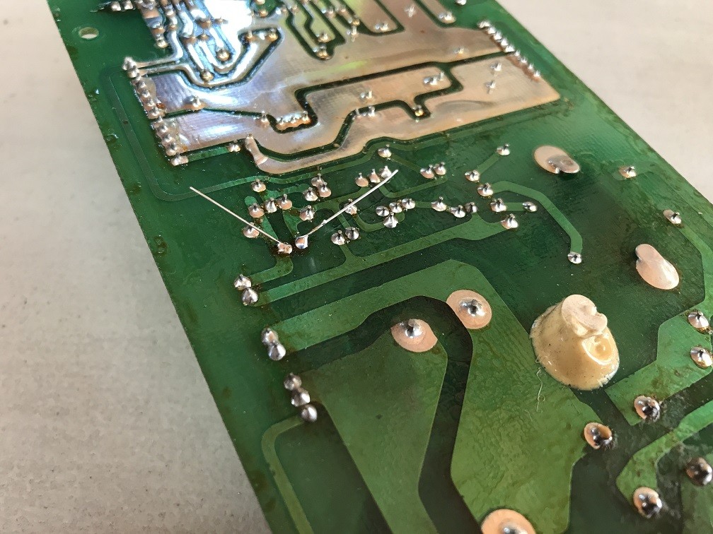

AAAAAAND ... on C407 ... desoldered the bottom but which is supposed to be the positive lead???
it looked like the original was coming through that "upper" positive (the one i've got the leg sticking through in the pic) but i see the "+" to the right of the "lower" positive in the pic
Postive is on the bottom.
Edit: I see what you're asking now...doesn't matter which one of those lower holes you put the positive lead through. As you can see from my pic, those two holes are solder bridged.

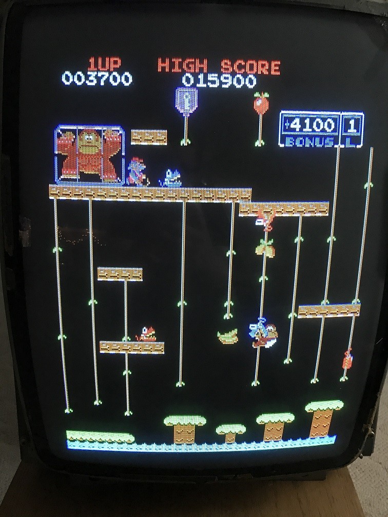

DONE ... finally ... all caps and resistors replaced for the 20EZ chassis and sound amp (note to self ... next time, start with the resistors first ...)
other than a good spot check, is there anything else i should do before hooking this all back up? any continuity tests? while everything looks good, i'm nervous (e.g.) two solder points are gonna get bridged that shouldn't be or some other rookie-type mistake

I always make sure I put each cap in the right direction one last time. In other words, make sure each cap has its negative stripe lined up with the stripe on the board. As you check each cap, mark the top with a sharpie.
When you first fire up the game, the screen will probably look like crap. Don't panick, your probably going to need to adjust the pots for a while to get a good image. Good luck!
There's no better feeling than seeing a monitor come back to life after a cap kit!
run it for at least 20 minutes than set your B+ to 108vdc and once that is done than do any other needed adjustments.
holy crap. it actually worked when i plugged it all back in (even the sound amp that i savaged hahahahaha)
now all i gotta do is adjust that B+ (i guess i should invest in a multimeter) and i think i'll be able to dial those colors in perfectly.
God capkits suck but my fear of them has been somewhat alleviated ... now i have at least one more Sanyo to go :004_scry:
for anyone reading this that's never done one because of trepidation: if i can do it, this should be all the proof that - with planning, organization, and patience - you can do it too

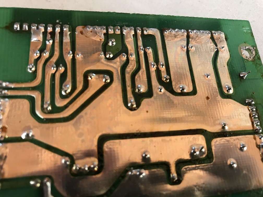

so i'm recapping a Nintendo PP-7B PS ... since this thing is power-related (not that the CRT isn't) i'm trying to be as delicate with my solder points as possible (so as not to create an unintentional and possibly destructive bridge).
but holy hell some of these solder points are very close along parallel traces. other than a delicate hand and eye, any helpful tips to not create an electronic-time bomb after recapping this thing?
below is one of the first caps i've done, but some of them have solder points (near the power headers) even closer:
I capped a Nintendo Power Supply last year...and holy crap that was a lot of work and required a steady hand and some patience.
You need to get a multimeter and put it on continuity and touch each probe to the 2 solder pads in question. If you hear a beep, then you have bridged the traces.

EDIT: Also remember to try and not bend those legs over and it looks like you might want to be more conservative with the solder. Easier to add more solder than it is to take it off...especially if the legs are bent.

I have a solder sucker....but I also use copper braid to do final cleanup on the pads.
Also note the top side of the boards sometimes have markings for +/-. Often its just a dot near one of the holes.

always remember that "too much solder" picture may not happen due to too much solder but not enough flux/too many contaminants will also cause that type of appearance which you have to remove all solder and hit the connection again and maybe again depending on what type of flux/solder the manufacturer originally used.
