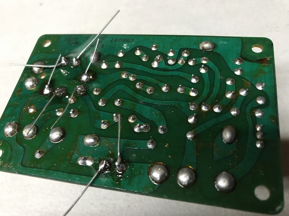

a bit of a blood bath on this Sanyo EZ20 soundamp, i know but ... my work so far:
so ... questions ...
* yeah, it looks like i'm toasting the board quite nicely where i've soldered ... i know my solder-pullit has suction, and i think i'm heating the stuff hot enough but it takes like 15 times of trying to snag that old solder to clean the holes on the board (thus, the iron stays near it longer, thus the burn marks i'd imagine). any guesses what the hell i'm not doing right?
* secondly ... notice how some of the solder joints are soldered together (two different components) ... is it supposed to be like that? specifically the little guys with the heat sinks seem to have a nearby solder point that's soldered - not just next to it - but TO IT
any and all other critiques welcome as well ... thx guys ...
sometimes the old solder needs a dash of flux to soften it up so you can get it with your sucker
the yellow arrow is where the flux needs to be cleaned off
orange circles are where the wires need to be shortened so as to not short to another circuit
DO NOT PLUG IN THE WAY IT IS !!!
that's opposite of what i hear (long time repair peeps), read (randy fromm arcade school), and watch (on YT).
use a little solder itself for de-soldering purposes, never flux.
flux binds the solder and makes it more difficult to "suck out".
flux is best used when soldering on new components.
it looks like your using the wrong solder. it looks like 60/40 your using and if you use the (with proper ventilation) a lead based solder like 63/37 you will get much better results on the older boards. or maybe not enough flux too.
second i think i know where your talking about on the solder pads that are connected and in theory you could bridge every solder pad together that is electrically connected and it wouldn't hurt so yes its common when multiple component leads are on the same trace and right next to each other to have them connected/bridged together. if they are not on the same trace than NO they shouldn't be bridged together.
heh sorry if i wasn't clear ... yes, definitely gonna trim those extra lengths of wire off before putting it back in the chassis. just had left them there as i was soldering cap-by-cap
yes that is 60/40 just as i suspected and if you switch to 63/37 it will flow much nicer. BTW: what is the manufacture date on that solder?? it looks old and flux does go bad over time. a couple years old is no problem but 5-10 years you start to have problems. here is what i use and i really like it.
Yes. If you see 2 solder blobs touching...then it's supposed to by that way.

Try not to bend the legs over before you solder them into place. It can be difficult to desolder the legs later if they are bent over.
Also, get this:
https://www.amazon.com/Velleman-VTD...=1492180104&sr=8-12&keywords=desoldering+pump
It changed my life.

so i've worked through the caps (slowly improving) but HOW THE HELL do you pull the components with the heatsinks???? i've reflowed solder on the parts including where the heatsinks are attached, and they just don't wanna budge
i can even feel the board itself getting hot to the touch. i'd be surprised if i haven't fried this sound amp at this point.
any helpful tips would be wicked appreciated
unscrew the transistor off the heat sink and than desolder the three legs and it will drop right out.. BTW: if you get one of those cheaper heated desoldering guns like theyeti suggested you will be amazed at how clean the holes are and how easy the components drop out.
BTW: the tips on those guns need to be replaced every 1-3 chassis worth of work otherwise they start to drip solder back out of the tip and for the time it takes to clean the tips i would just replace them since they are only a couple dollars.
