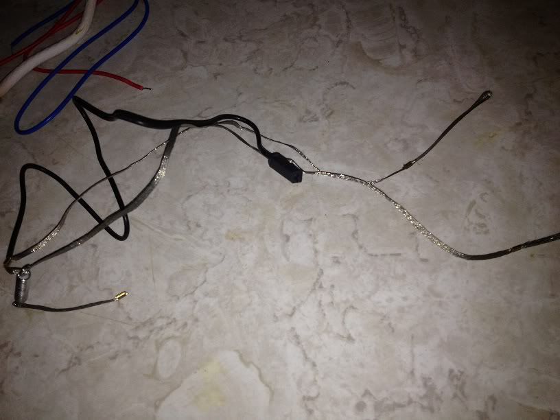

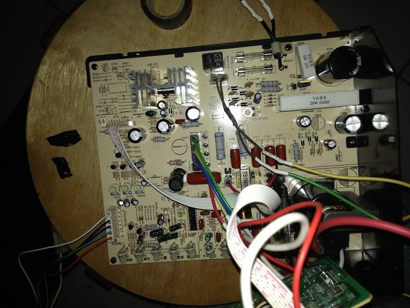

So i just installed an 8 liners chassis. I used a tv tube for this chassis. I turned it on and everything seems fine except the colors are all dull. Adjusting the pots doesn't seem to help. I didn't use the degauss cable that came with it. I used the one from the Tv. Any ideas what I did wrong? Thanks.

Nope. It was like that when I got it. I can still turn it and i just left it alone. Doesn't seem to be broken.
I can't see any red in the picture. Have you tried swapping the the red and green inputs? I did a tube swap not long ago and that fixed my problem.
And a manual degauss .
Ok i swapped the red and green inputs and it made it worse. It still had that dull green effect.
was the tube good to begin with?
I just went with a friends judgement. He gave me the tv and said it was ok. So i went with that. Plus the tube was dark grey so i thought yeah it's fine. I'm gonna put it back together and try some channels to see if it really is bad.
