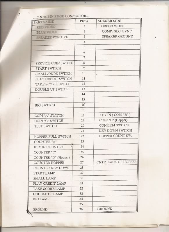

Here is a scan from my manual. It only shows the large one though. The next page for the power connector is missing. If you still need info. I can dig around tomorrow and find one most likely. Also. I have a complete, unhacked harness with the button sockets, video input and test panel for $25 shipped.
