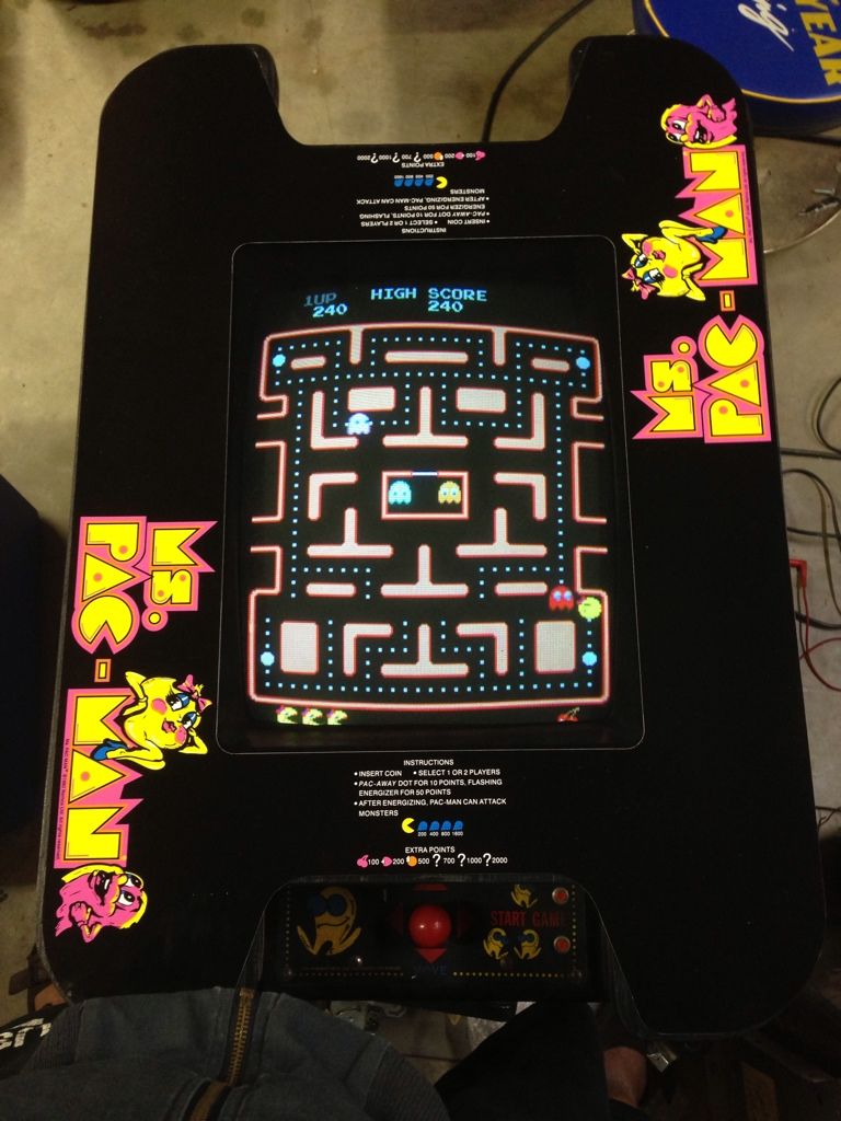

So I hook up an older 8-liner board and the picture looks great, except the pincushion along the top/bottom and a slight edge curl.
Has anyone capped one of these boards? Cap kit or value list available?
Just trying to figure out a solution, pincushion is just a little too much for me to ignore.
Any idea what the B+ value should be and where to measure? There is a "B+ Adj". POT
Man, I believe the pincushion depends on what yoke you use... so it kind of changes.. I'm not sure you can get it to dissapear with a capkit. Some of the models have a pincusion adjustment, though.
Some of the caps have a slight dome on the top, very suspicious to me of a poor condition cap.
I may go ahead and try a cap kit, maybe worth a shot.
Are you talking about an 8-liner game board or one of the universal replacement monitor chassis sold by 8-liners.com ?
