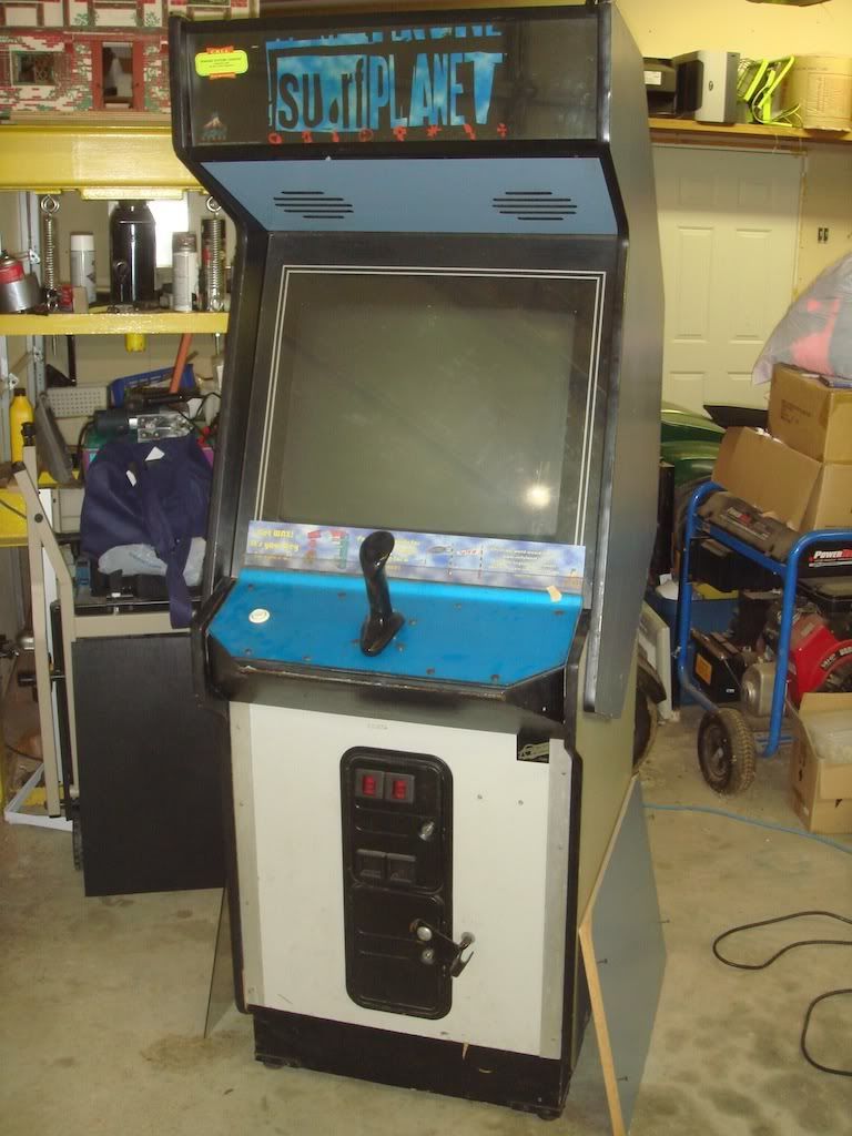

I never heard of this game, but for a $75 25" Dynamo cabinet, I figured I'd risk it.
Plays blind, chassis has a blown fuse and magic smoke was released from the diode area when the fuse was replaced. Betting no isolation transformer at some point in the past.
So inspection of the machine revealed 2 power supplies, both with 110v applied, but only 1 hooked up to the harness. The tube is missing the plastic key around the neck pins....
Already removed the extra power supply.
