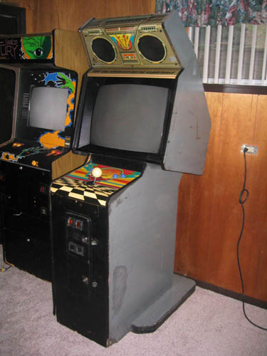

Unfortunately I'm not much help with your question. My 720 was like many I've seen: Missing a big chunk of the front of the cab, due to that front bolt either being ripped upward, or the peice just cracking off due to the front panel being weaked by having a large hole so close to the edge. I've even seen some which had metal plates put on the outside of the top-front of that panel to correct for the cracked/broken hole there.
here was mine when received:

Nevermind. Just found this pic of my brother's, and it has a huge plate on it. Probably installed by an op.
Here is mine. Notice the spot for the large bolt, but no other holes. If it ever had the plat on it, you would expect to see three additional small screw holes.

I noticed some 720's have a white ball on the joystick while others have a black ball. Mine has the black one. Is there any reasoning behind this?
Re: 720 Restoration Question
heh... the white ball on the pic above (my brothers machine) is a freaking cue ball. I have actually seen this a couple times, but it is not factory.
