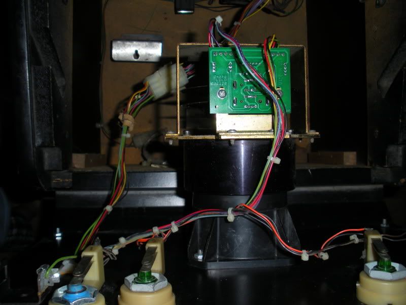

machfelon just came and picked up my 720. When he arrived we had to tweak the optics board a bit to get the joystick to work properly. Since then the game has been resetting/having graphic issues when you try and coin up or use the CP.
It isn't consistent. We coined up the game and played for a bit before he left to test out the joystick and it worked fine. He just got it home an now can't get the game to load.
All the tests indicate the RAM/ROMs are fine.

I have found many problems that were easily fixed with just the power supply, either buy adjustments or replacement. It very well could be the power supply and should always be checked. I have gone on service calls and found the power outlet was turned on by a light switch. If it is a switching supply it probably needs adjusting. If it is an original it probably needs rebuilding/replacement.
This is such a common problem I put it in my signature. I put the allways in there on purpose. In ham radios I have a cheap meter hooked up to my supply at all times so I can watch spikes, drops, and losses. I would hook a multi meter to the +5 line a watch for changes when you coin up or do whatever is trigger for your problem. If it is not the +5 volt line then check the +12.
If it is not a supply problem then I would look at inter-connectors/cables.

I can't tell if the optic board is a red herring. Machfelon just unplugged the CP and the game booted fine, plugged the the CP back in and graphics issues. Now the even the test mode is getting graphic errors. Could the CP be causing this?
I would check the power supply with the cp unplugged and then with cp plugged in. It sounds to me like something is being shorted to ground.

Always bad power issues with 720. When got mine, the connectors were burnt and I had multiple other power related issues. Replaced it all and got a new switcher and I was fine. After about 7-8 months, I started getting garbage occasionally on the screen as I started running more games. When I turned up the power supply, it all worked fine. I tested the +5v on my boards and they were running about 5.04...which is fine..however after a while, I decided to measure my power direct from the switcher and it was 5.3v! I was getting the same readings in my wiring harness, and finally figured out that the power loss is occurring at the connectors from the board and wiring harness (where there were burnt connectors before). I've seen 3 720 boards with burnt connectors, so this is obviously a common problem for whatever reason. I have new ones sitting in my shop right now, but haven't had a chance to replace them yet. I think my first suggestion would be to test your 5v on the boards and then test your switcher as well, if they're both a little over 5v then your issue is somewhere else. If your switcher is putting out 5v and you're like 4.75v on your board, you might turn it up to get 5v on your board, temporarily, to see if that fixes the issue. If it does, then you need to see where your voltage drop is. Like I said, I tested my wires and they were fine, but when I checked the voltage on the solder side of the board of my connectors, that's where I found my voltage drop.

sounds to me like the 32mhz crystal in the center of the board is going or has gone.. when i reparied a 720 board i have, it had THAT VERY COLOR screen... same symptoms.. i really dont think it has anything to do with the PS.. its a switcher so i dont think thats bad....i mean you can get another switcher to see, but i dont think its that!

The crystal is used by the clock generation circuit. If the crystal is bad then the clocks would not work and nothing on the main pcb board would function. I do not know enough about the 720 hardware to know what the visual symptoms of that would be, but it is one of the first places to check after measuring the power supply.

My 720 has died at least twice resulting in (initially) constant resets and booting to garbage. The first time it was the +5v power supply, the second time it was the GND leg on the T-11 processor - it had corroded and fractured (I don't think it had ever been removed from the socket).
Also, as far as I'm aware the +5v comes from a switch mode power supply but the other voltages +/-15 I think) are supplied from the AR board behind the coin door and from experiments on my test rig it needs the +15v to the CPU and video board (at the least) in order to boot.
