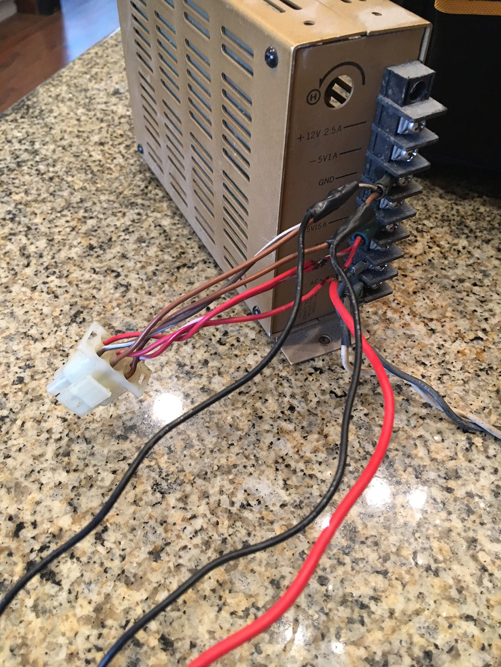

For those that have a 720 or have a photo of the power supply close up I really need it. I searched and searched and couldn't find anything clear. I'm looking to see what others that have an unmodified wiring setup look like. I'm repairing my wiring from a previous owner and got it all set I believe, but I think they tapped into the power supply and went directly up to the J20 connector to help alleviate some strain on the wiring that is normally used to get power up to that connector.
Here's a pic of what I got, I think I can just get rid of the extra long power and ground wire you see they added and connect the shorter/stock wires to the power supply normally, BUT I want to make sure :)
Thanks for any help.
PIC:

I took a look and unfortunately I'm not overly confident in following the schematics alone. :( Hopefully someone will have a pic to reassure what I'm leaning towards. Thanks for the reply!

brown goes to ground.......not fg
red goes to +5
all current is white and black..it looks right from what I can tell
good luck and if you need help let me know I make all new wire harness for 720
chad

Thanks Chad, I appreciate the help. So things look correct then, just looks like someone tapped into the red +5 and added another wire which they ran up to the red connections on J20, tapped into the ground with the black wire and ran that up to the ground/brown connections on J20. So now that I fixed the other hard wired connections at the bottom of the bottom board I should be able to remove these two new wires and everything else should be good right?
Do you have JUST this harness/connector? The main wiring harness is clean and not hacked, this connector/wiring is the nastiest.
Thanks Chad!
