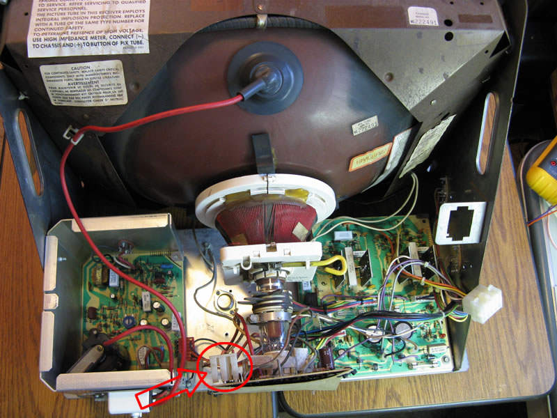

Check this connector on the neck board. If it is not connected, a super bright picture is the result.

In Bill's pic he mentioned this connector being off and you saying it was on.
I just rebuilt both the deflection board and the HV recently and while moving this connector one of the wires just FELL OUT. When I went to test the other, it popped out with barely any tension. I re-pinned and everything was AOK.
Bill B.[/QUOTE]
No, those pins are definitely well connected. I get good continuity from the back side solder-pads of the pins on the neckboard through to the P900 pins on the HV cage.
