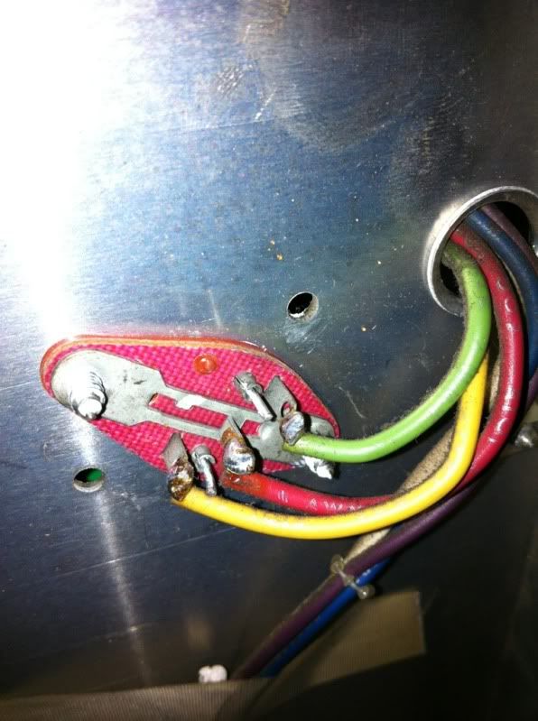

Check the 2 fuses in the middle of the deflection board. If good the reflow solder on all the sockets for the chassis mounted transistors.
Andrew
No the red, green, yellow, blue, white, purple wires on the sockets. From all the 6100's I repair there is always cold solder on those.
Andrew
You solder in the chassis mounted transistors ?

Now to the 6100.... I guess my main issue is that I do not have any "crackle up" when powered. Nor glow on the neck board. I did reflow solder to all of the power connectors and to the wires near the TO3 transistors. Still the spot killer light comes on. I bought a LV2000. The two lights come up when tested like it's working okay, but once the power connector where reattached, the two lights came on but the spot killer was back on as well. A real problem that I am having is in the TO3's. The (3) 16 show voltages "in range" (+24, +25, +35) But the (3) 92 are where I am having an issue. One shows -25, but the other (2) are showing +8. Not sure how that's possible. I tested the transistors, but they are fine. I changed them out anyhow, same result. Spot killer light on and no crackle up. I'm guessing I need to search for that all elusive HV diode on the HV PCB to fix my HV issues, but I'm not sure that corrects my TO3 issues. If anyone has come across these voltage issues or would have any advice, it would be certainly appreciated.
