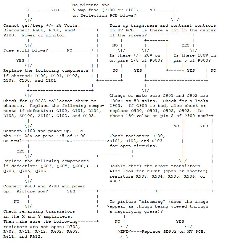

Troubleshooting a 6100 monitor in Black Widow, can use some help. Read 6100 FAQ, numerous threads but can't seem to find a solution.
Symptoms
- Low B+, stuck at ~25VDC. Adjusting pot does not change voltage. Black screen

Make sure your low voltage section on the deflection board is working, and that you're getting +25V and -25V at the input connector to the cage. If one is missing, you'll get low B+.
Measure the voltages on the deflection board, at the input connector with the cage unplugged, and then also on the cage pins with the cage plugged in. You may have a broken wire or bad connection in the connector. The solder joints also love to crack under the solder joints on the cage connector, but if you have two cages that are doing the same thing, it's more likely the wiring, or the deflection board itself. (Also, if you don't have an LV2000 or LV6100, install one.)

If you're only getting 25V B+, the cage basically isn't working, so it could be almost anything, so start with the power. Test all transistors and diodes (you can do most of them in-circuit). Also, the pots on these go bad very frequently, so it's good to just replace them.
You replaced the Zeners, so that's good, but just make sure you didn't mix up ZD902 and D902, as that's a common error folks make. (You're probably fine, but it doesn't hurt to ask.)
Also, is it the P329 version, with the HV cutoff pot/LED? How is the pot set?

Have you checked the output of the 555? Start there, trace it up through the base of the HOT. There should be a schematic with DC voltages of all the resistors/diodes/transistors. Once you know you have a good signal going to the HOT, look at these voltages, and see whats out of spec.

Moved to the 316 HV cage and was able to get the monitor up and running with a full rebuild. Picture is shaking, due to low voltage. I'm stuck at +155VDC and cannot get any more voltage out of the adjustment pot.

ZD902 still tests fine with the DMM, any other areas that would give me the additional voltage I need? Double-checked D901/D902 as well.
Did you replace ZD902? (Sorry, wasn't clear from last post.) If not, replace it anyway. It often gets baked from the nearby power resistors. Also, you can't test a Zener with a DMM. (It will look like a regular diode even if it is bad, as you can't test the reverse-breakdown Zener function with a DMM.)
Also, you don't want to run the cage for long with it in that state. Normally, the pot should be right around the 1-2 o'clock position (where 12:00 is the point closest to the focus block), in order to get 19.5kV, when the cage is operating properly. Anything else indicates something isn't right.
Also, make sure the connector on the cage-mounted transistor on the front (i.e. to the left of the focus block) isn't burned, or showing other signs of heat damage. Many times they are (in which case I remove the connector and solder the wires directly), else I clean the transistor legs with my Dremel wire wheel, as they can get some oxidation built up on them.
Also, it's worth doublechecking all resistor values, to make sure none got mixed up. The silkscreen can be confusing in some areas, and it's easy to misread the resistor numbers in some areas. (Stupid stuff I know, but it's worth sanity checking.)

ZD900-902 was replaced, good to know on zener testing. I might just replace the zeners again to be 100% sure. I've already changed out the BU406 and checked the socket.

UPDATE
Issue ended up being another bad ZD902, not sure if I had a bad part or the new one was zapped. Holding steady at 180VDC.
