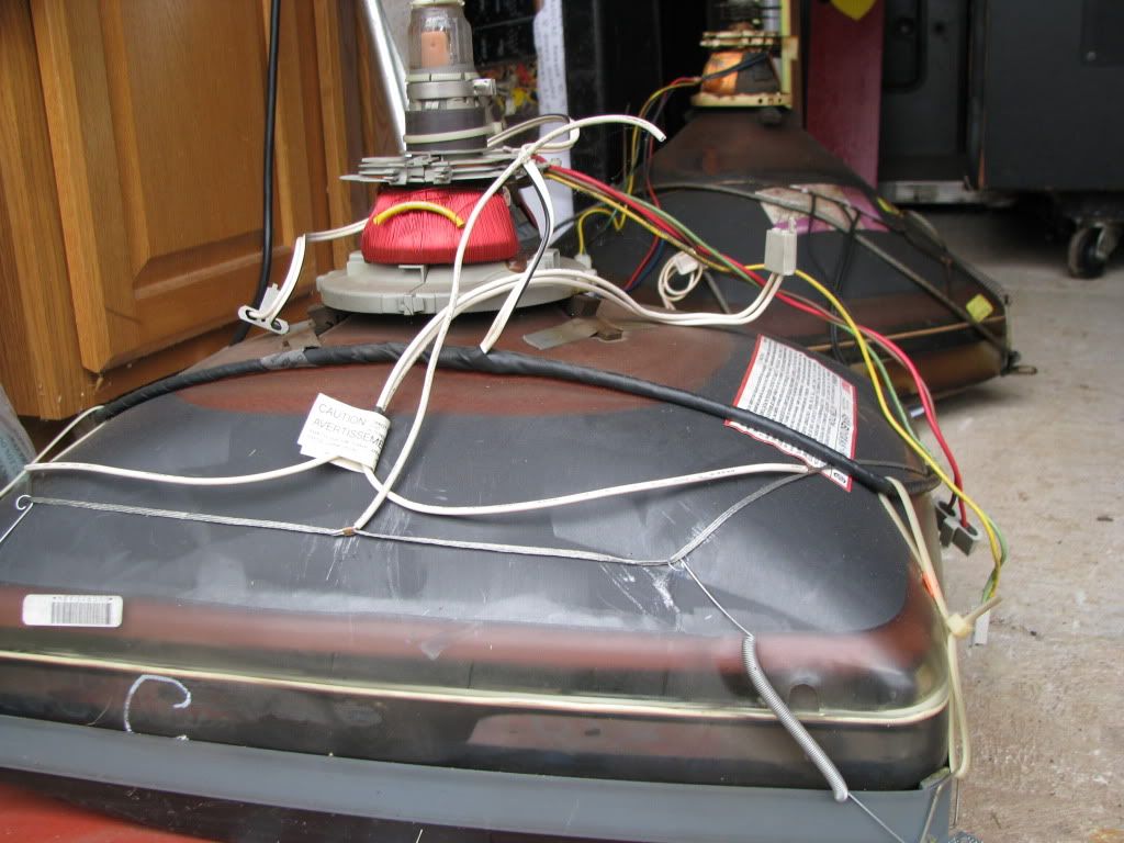

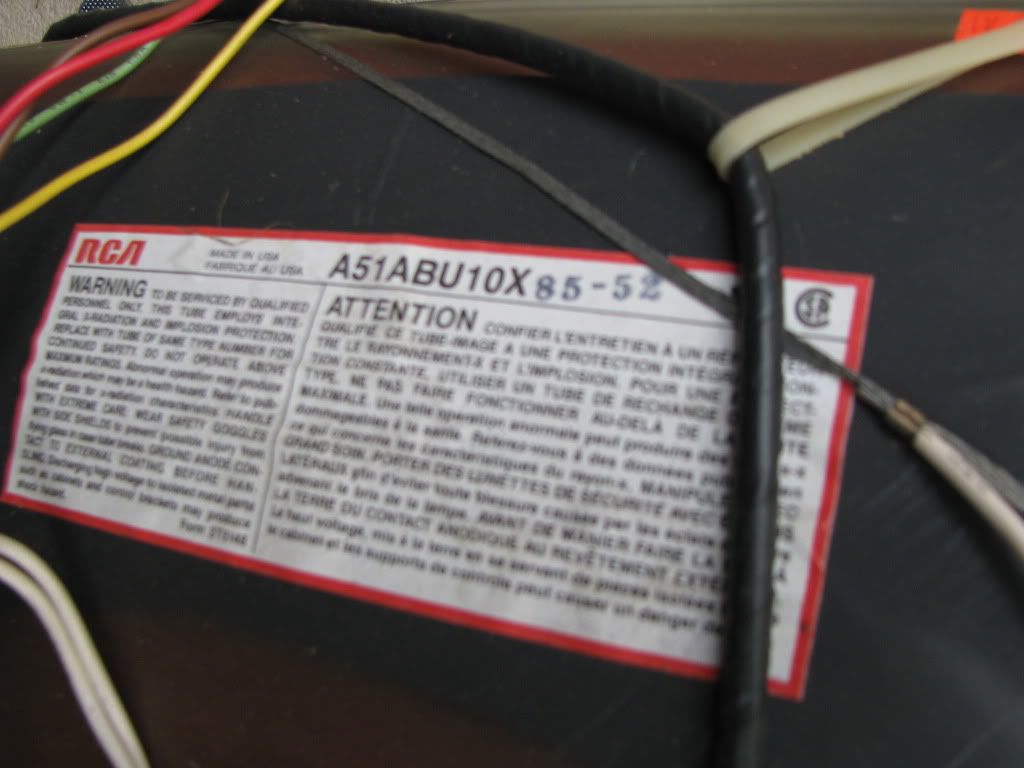

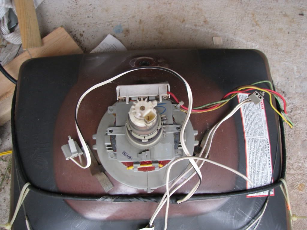

I found a tube in a yard sale tv - A51ABU10X. When I picked it up, I didn't notice it was a 20" set. I figured I found a dud, but today noticed that it looks like a 100deg tube, and I see from the BK list that it's a CR24.
I have a 6100 with greater than average burn. Would it be worth attempting a tube swap, IF the 20" tube ears will mount to the 6100 frame? Here's some pics and thanks for any advice.
If the neck is the same diameter you can get it to work, you may have to make an adaptor if the pinout is in a different order.....or you could open up the amplifone connector and move the wires around to suit. If the plastic part on the end of the tube doesn't fit you can removed it, you will need something to soften the glue first.

No, I just noticed it looks flatter than the 90deg tube. Maybe it is? Can anyone confirm? Thanks..
Look at the number cast into the back of the tube. First 2 numbers will be the size. Then there will be a V. Numbers after the V will be the degree. Picture looks like it is a 20V110

I think it would be better Joey to use a 90 degree tube than a 110 degree, as your early pics clearly show
At least there are documented cases of the 90 degree amplifones working in a wg6100 setup. They only complained about slight bowing at the sides
That tube looks too different, with multiple pins in the triangular area. Looks like a sony type tube, which uses incompatible voltages
Well, you don't know until you try. If it is a CR24 neck, and the proper heater voltage, then it will probably work. Try it. Worst case, you won't be able to converge it. It also won't fit in the frame without modifications, but just leave it mounted in the TV face for testing - if you can get it converged correctly, then you can worry about mounting it later.

..and we have a loser! I confirmed it's a 110deg tube. Need to hit the thrift stores this weekend and find more tubes..

Dude, pull that socket off the end of the tube. When you do find a compatible tube, you will need that socket to replace the other one which will probably be incorrect.

And, of course, you should save the neckboard socket from the television. Those are kind of hard to come by, and required to build CR24 adapters for rejuvinators.
I'm also not 100% convinced that this tube won't work - sure, it's the wrong deflection angle, but it might not be too bad. It's possible to jam a 90 degree tube in a 6100 and have it usable, so I don't see why a 110 degree tube would be any worse. At least this one already has the right connector on it. It's still worth trying, if even to see how far off the convergence is.
