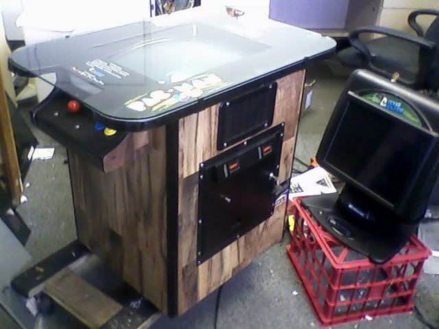

I just got a stern scramble cocktail. The board is DOA. Will the 60n1s work in a cocktail as I cannot find that info about them.
Yeah, I am going to jamma the cab for the 60n1 just didn't know if they had a cocktail setting. The scramble board, wiring harness and power supply are coming out. The only thing I'm reusing is the isolation transformer for the G07 and the CP as they are 11" variety and seem hard to find a suitable multi replacement.
Yes. I turned a gutted and converted Scramble cocktail into a 60-in-1...
Modessitt: did you buy new glass or clean the scramble paint off the old one? mine is shot and flaking bad.

As I said, the game had been badly converted (to Ajax). It was missing the top glass and had some type of plexi on top with some Ajax stickers on it.
I bought a new glass top (sized for the Midway Ms. Pac but it fit pretty close) with a new Ms. Pac underlay underneath...
