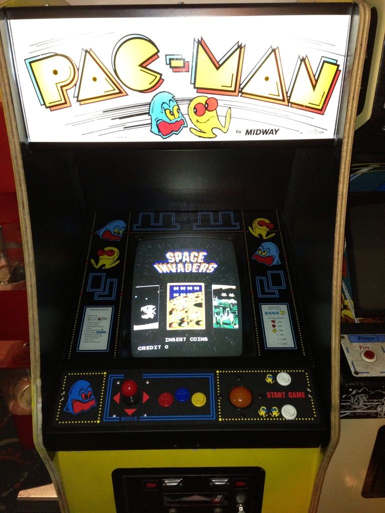

yeah, I used the Lizard Lick adapter in mine like I showed in my video. That adapter is great since you don't need to use a separate power supply. So, if you get one of the other jamma adapters out there you'll need to wire in a power to the adapter. Looks like that jamma board kit includes it. That doesn't seem like a bad deal for the power supply, adapter, and board.

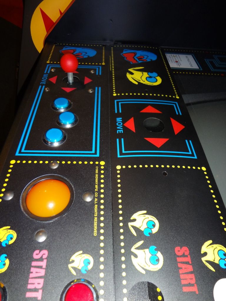

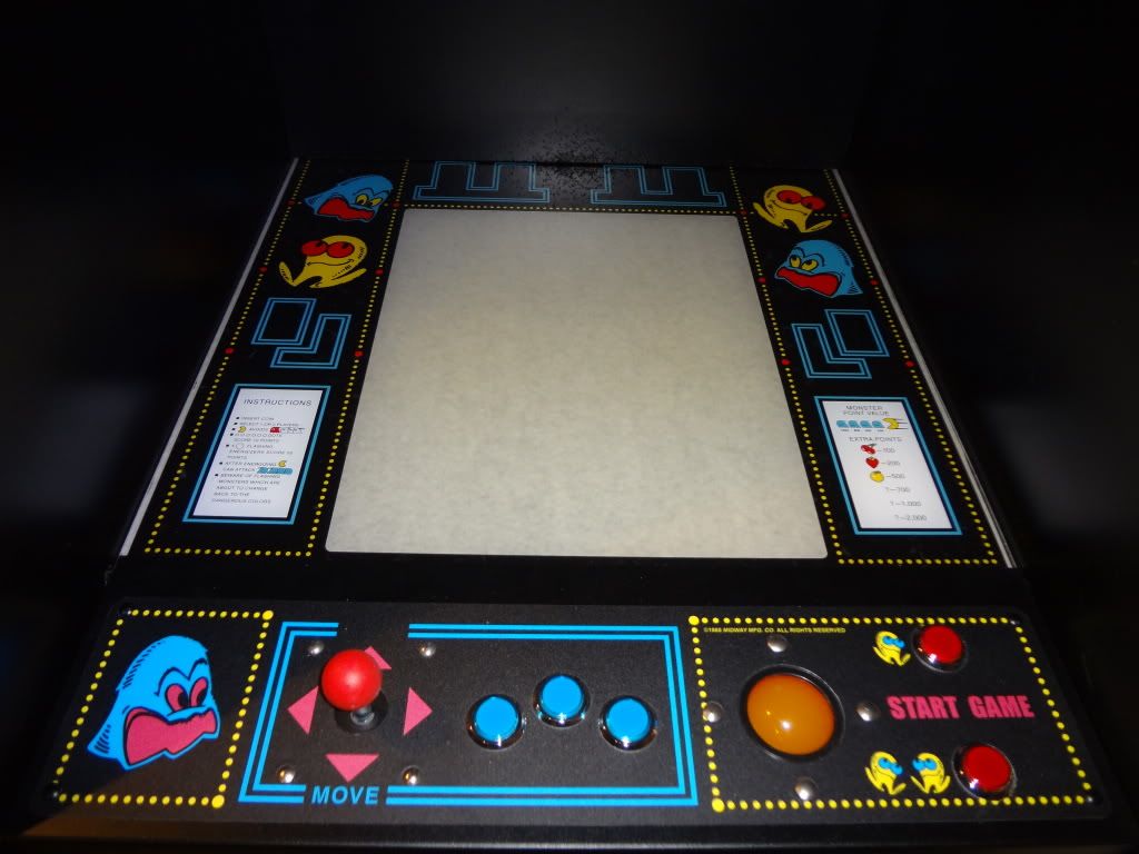

BTW - I eventually got pretty annoyed with using the P1 and P2 buttons for the fire buttons so I went out and bought a repro control panel that has the extra button holes and that has worked out great. You might wanna do that too and save your original control panel.
This is the one I have on mine now:
http://mikesarcade.com/cgi-bin/store.pl?sku=CPMSPACURX

I don't miss the trackball. But, I own a centipede. :)
I prefer it the way I have it with the two buttons and the joystick. I eventually got bored with the 60 in 1 and now have it plugged into a MAME computer. It rocks. Great cab to have. I primarily play Ms. Pac on the cab so I like the joystick in the center the way it was intended.

The only issue I have with the multi CP's like you have Phet that I was going to go with is they don't go near as well with Ms. then Mr. I'm going to see how long I can go with the P1/P2 buttons and standard 4 way before upgrading. But heavily leaning to the nice trackball one if I do.

You just need to get the right CPO. This blue multi nonsensical CPO that Arcadeshop sells is a horseshit abomination.
