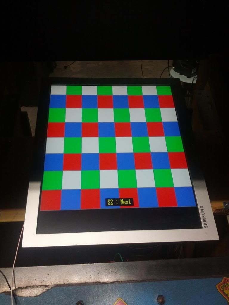

Hey there,
Not quite sure where I am going wrong here....
http://i14.photobucket.com/albums/a324/X_EGO_BRAIN_X/IMG_20130125_195907_zpscad75b06.jpg
I have everything set up properly, but the 60 in 1 on this LCD is off center. I've used the monitors adjustments and this is the best I can get. Some games are missing a section due to being cut off.... I can't seem to get the image centered no matter what.
Any ideas on how to get this worked out?
Dip switch is set for VGA.
some lcds just won't cooperate.
did you have the pcb turned on then hit the monitor factory reset a few times and try the auto adjust a few times.
if you are set on using this lcd and it doesn't have geometry settings, then you'll have to buy a cga to vga (gonbes) card which will provide the geometry adjustments needed to center the image on the lcd. you set the pcb to cga then run it through the converter into the lcd.
