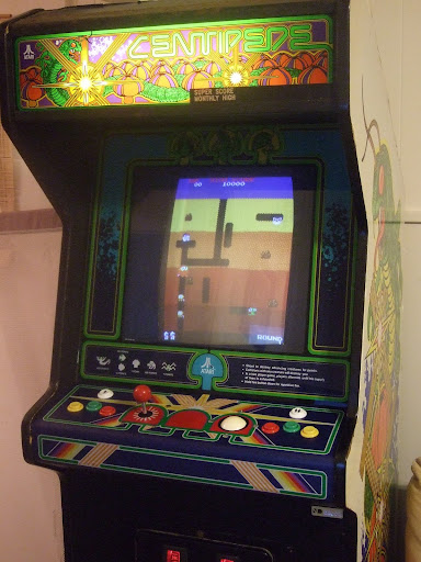

Here is mine
I know the joy isn't centered, but this let me play left or right handed for a lot of games. I've only done a dozen of these (I say that as truly a newb, the guys who do these have done many many more) but I thought centi was the best cabinet to do it to so far.
Here is mine
