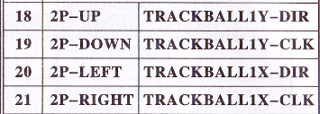

You take the 4 wires in the middle of your connector (which you leave connected for the +5 and ground) and connect them to the Player 2 Up/Down/Left/Right wires.
Here is the pinout of the CON3 connector:
And here is the way it connects to the Player 2 directional wires:
If it still doesn't work after that, you either have a defective 60-in-1 pcb, or incompatible/defective trackball optic boards...
