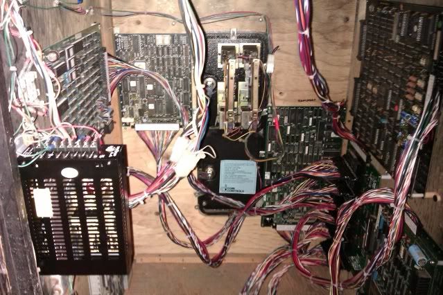

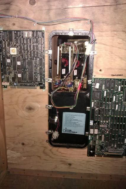

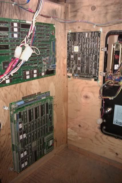

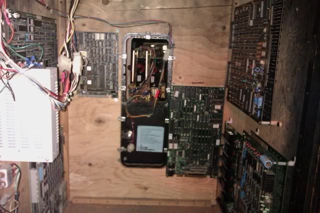

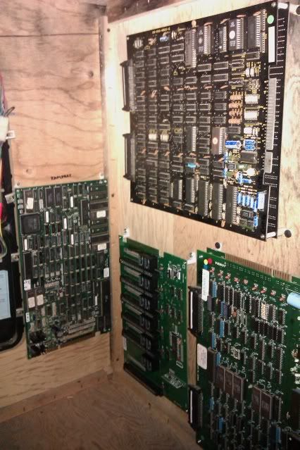

I started re-working my MultiJAMMA last night.
I removed Clay's 8-in-1 (I don't like that it keeps all 8 boards powered up at once), and then started mounting the 6-in-1 board in the cab, and the main 6 PCBs I plan on using.
I still have enough room to mount another board or two in case i want to switch stuff up. Right now I'm waiting on some JAMMA extension cables to show up so I can finish hooking everything up and then test it out.
Pics:
