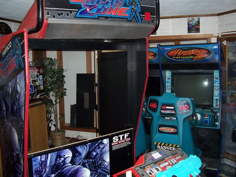

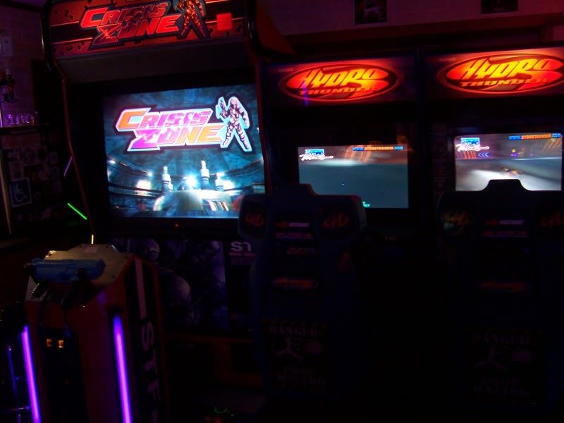

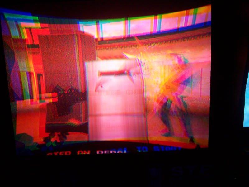

I spent yesterday afternoon swapping out the 50" mitsubishi in my Crisis zone with a 50" Hitachi. About 2 months ago the convergence went out. After changing convergence ICs and countless resistors and capacitors and not fixing the problem I started searching Craigslist for 50" tvs. Finally after several weeks of getting no responses from about 8 "sellers" I got a call yesterday. Picked up the Hitachi for $100. I took the mirror out and cleaned 8 years of film off of it as well as the projectors. It was about an 1" taller and wider then the Mitsubishi, so I had to remove a lot of the blocking inside and wrestle it in. Turned out great, the tv has a great picture and no screen burn. Has anyone else had luck finding 4:3 50" tvs and swapping out in Deluxes?
I haven't done it but I know the day is coming and I'm on borrowed time with my Rally Deluxe. I know projection screens aren't as bright as an LCD or tube, but did you notice your picture being a bit brighter putting a new/old projection screen in there? That's my main complaint, is picture brightness compared to my other games. I did take off the front screens and clean the mirrors and screens, as well as adjusted it up as bright as it would go without blooming.
Yes, the picture is much sharper and brighter, it looks like new, I think I got lucky finding a tv with a really good picture.
