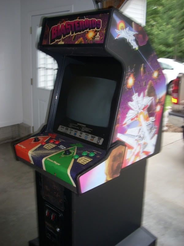

Now this was a great way to start my vacation week!!! :) Got a call from a cousin who spotted a game at a garage sale on her way home from work. It was an Atari Blasteroids that the seller didn't know much about and I was able to snag it for $50! While not a super popular game, this one is in pretty nice shape overall and I'd have to give it an 8/10 in terms of condition. It even has all matching serial numbers and, as far as I can tell, it has never been serviced. Right now it's got a few problems. The monitor is dead and a fuse in the bottom of the cab is blowing which I think is monitor related but I need to get a look at the manual to confirm. It's got a Sharp XM2001 in it. I can't get any sound either, but I did adjust the +5 after checking it and it was only at 3.5. Can't say for sure if it's playing blind so I think I'll concentrate on the monitor first. Overall not bad at all and hopefully this thing isn't too tough to get running.

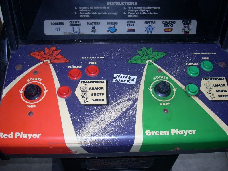

The cab and artwork seem to be in great shape! The CPO just needs a little love. Probably going to have to settle with trying to clean the exsisting overlay up, I doubt there's replacements avilable. Maybe get lucky on a NOS piece.

Thanks everyone for the kind words. This thing should actually clean up pretty well. The side art is in damn good shape with no major chunks missing. The coin doors could use some work but overall this thing is nice. This is my first venture into this hardware family from these late 80's Atari games so it should be interesting.
Thanks for the offer on that sound board, Mod. I may possibly have a failure on that oddly enough. The fuse for the 12vdc lo blows immediately on power up. A quick glance at the manual shows that feeds the sound board so that and the monitor appear to be my 2 challenges. The small fuse f701 which is also for the main power input is blown on the monitor so I'm suspecting bad flyback or hot. I belive Chad @ Arcadecup has the flyback if that turns out to be it.
