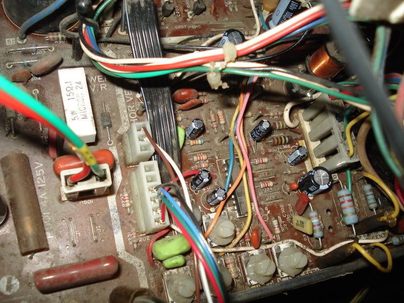

Show me a picture of the video input wiring as you have it hooked up to the 4900....
Oh... God... you're going to make me drag that out of Tron again? lol... Okay... lemme get myself motivated.
What is happening when you adjust the horizontal and vertical hold controls on the monitor?
Roll changes from WILD to the point where I can see the games menu, but still has a slight roll to it. And if you sneeze, or a mouse farts in the next room, it starts to roll again. VERY touchy.

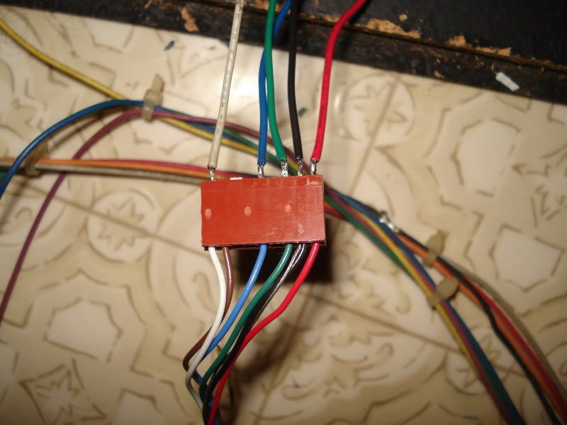

How it's hooked up... for easy of testing, I never do anything this ghetto for the permanent stuff.
I've tried it several different ways, but with no change. I'll try them all again if you think it would help.

Yeah, tried that when I was tinkering around back there... no change. And oddly enough, no change WITHOUT the sync from the adapter plugged in at all... looks the exact same either way. No change with sync to white, sync to brown or sync to both at the same time, and no sync at all. ... so... yeah, that's not good.

Double check your JAMMA connector and do a continuity check to make sure you have good continuity from the video connector sync wire to the sync pad on the PCB. And make sure you switched the Dip Switch back to CGA...
You have tried positive syncing? You gotta move the brown and white wires over into the harness next to it. So the order for that harness will be R,G,Blue,Black,Brown,W
