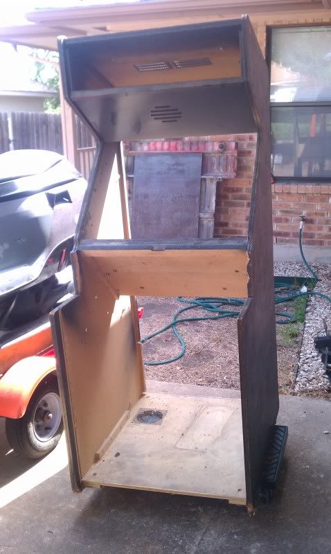

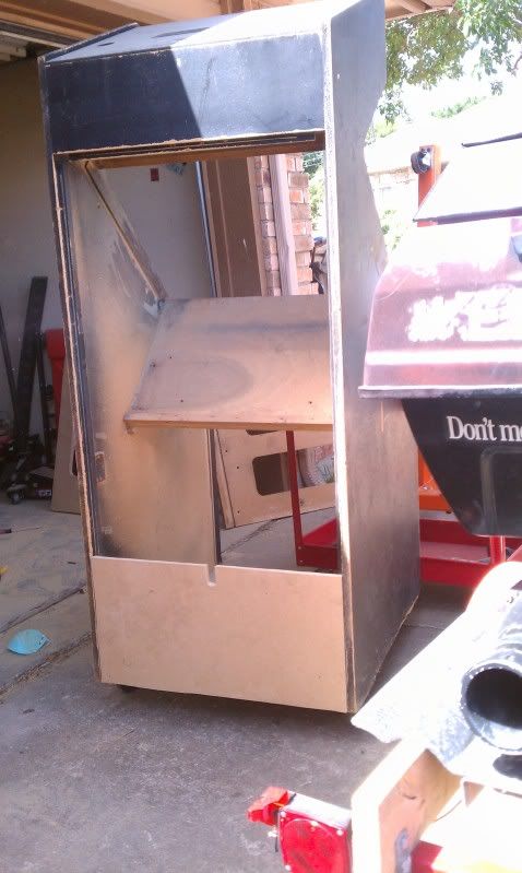

4 Player Cab for TMNT, Xmen, Sunset, and NBA
just a graphics shop?
Yes sir!! I just googled what was in my area, and asked them what they could do for me.
Said around 180 at first.. Then i was like, I didn't want to spend over 100.00 and we settled on 130.00 (tax included)
here they are! http://www.larryperezsigns.com/
They said they loved it and they want a picture of it installed. I'm going to have them make the marquee as well (they can print on paper that light shows through)
I may have them make art for the sides, but thats probably going to cost me an arm and both legs

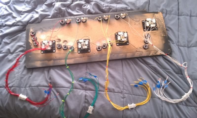

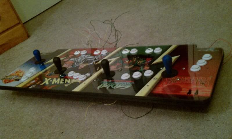

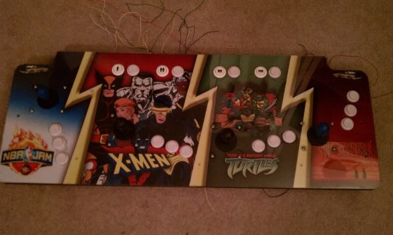

So i finally got the chance to put the CP together! I build 4 9wire harnesses for EACH player and color coded them to help out. They have a disconnect in them so I can take them apart to take off the CP when moving it around.
And a couple photos that I may use for the Marquee, Since these games didn't make it on the CPO
Looks very well done!
THanks!! I'm getting pretty excited over this.
Just finished completely wiring up the entire control panel, with all the quick connects for each player, took me like 2 1/2 hours, but I think its good to go!!
sanding/painting the cab is next!
Wow....That looks incredible.

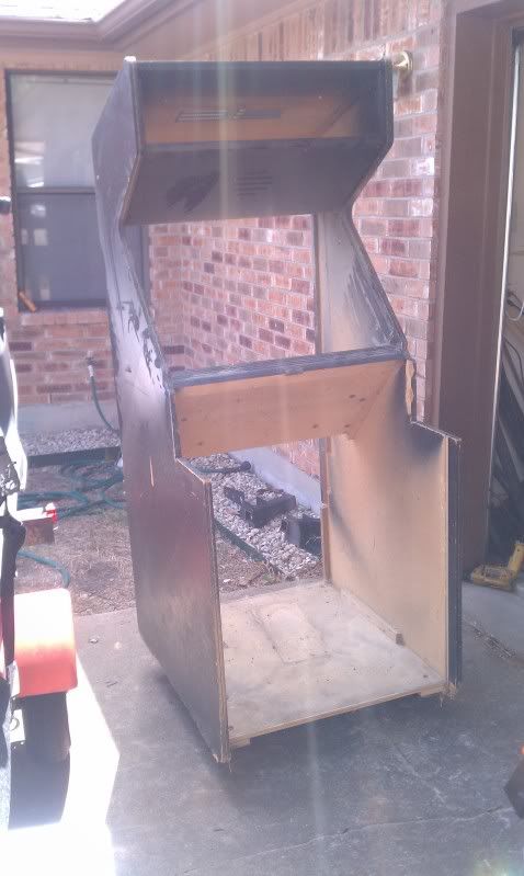

Girlfriend had something to do today, So I got time to work on this!!

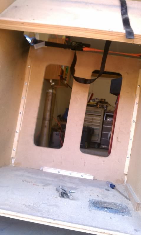

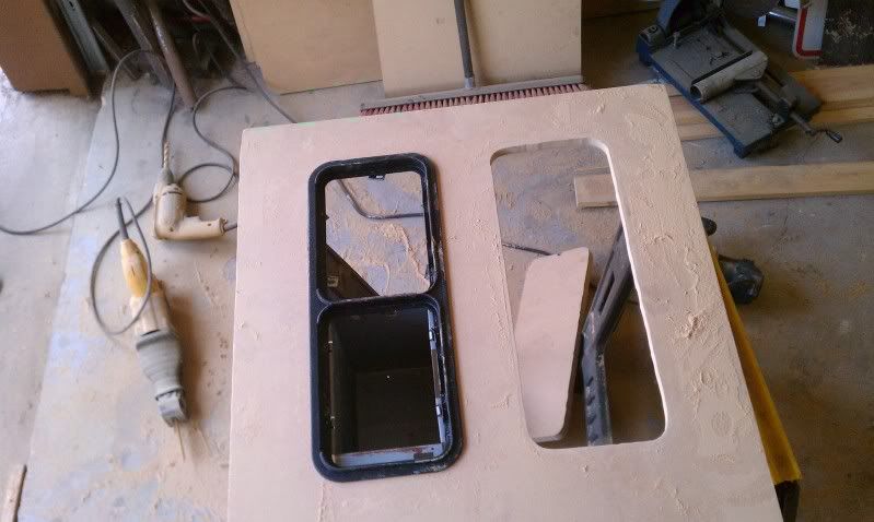

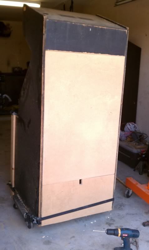

I was going to sand her down, but i kinda wanted to replace the front panel and rear panel due to messed up edges and the amount of holes in it.
Here is what I did.
I was thinking, that it would be kick ass to put 3 speakers in the top portion of the speaker area, just leaving the center grille, and then routing out 2 more just like it on either side of it.
Would this mess up the OHMs of the speakers by having 3, because if the games are 8 ohm, i can use 2 4 ohm speakers, but if I have 3, then its not going to work out..
Should i worry about this, or not? Or should I just consider making 4 speakers holes and run 4 speakers in it??

pretty sure you can do 2 4ohm and 1 8ohm if you wired them correctly :D

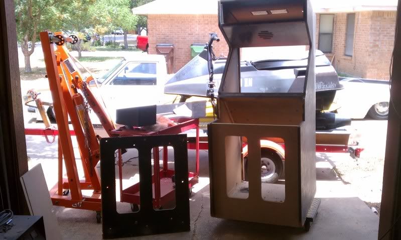

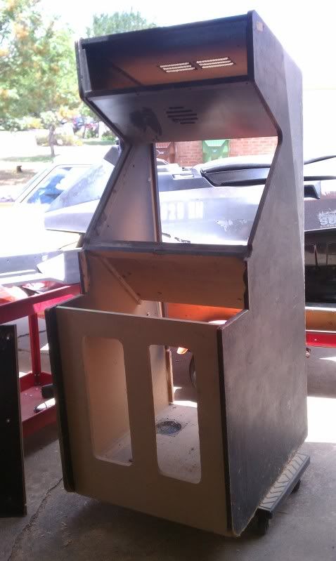

So i finished up securing the panels to the cab with wood glue and screws and I ratchet straps holding the whole thing together for the night, so it gets a nice bond, and won't fall apart when I'm moving this this all over the place.
Great job on everything so far. I wanted to mention since I don't think anyone else has..you are going to have to do the -5vdc mod to the switcher for the slot that houses NBAJam if you want the sound to work. If you need more info, I can elaborate.
I am ears wide open sir!! I don't have the switcher yet
