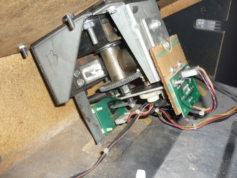

If it's not too much trouble, could you please snap a couple of photos of the steering assembly and it's corresponding connectors and post them here?
Thanks

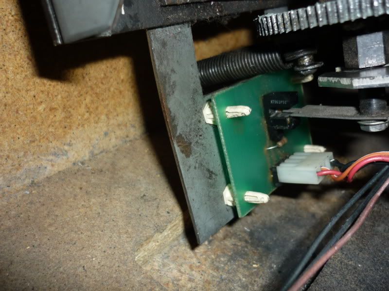

Photos attached. I couldn't get a good photo of the control panel's connector (photo #4; it's too bright with flash and practically black without), but it's a 9-pin male Molex connector (similar to this one) that is keyed on one side so that it will plug in only one way to the 9-pin female connector that comes off of the PCB. That is the only connector coming from the control panel. Photo #5 is of the female PCB connector that you can see a lot better.
I set all the dip switches to what I believe to be the default settings (dip 1 on block A is 'On' to specify upright cabinet and all other dips are 'Off'). The game still came up in 3D mode. Then I figured out that the big button on the control panel to the left of the steering wheel switches the video between 2D and 3D at any time. :D Everything works. :) Steering is touchy on this game. Just like a real F1 I suppose.

Thank you for the pics SanTe. That type of steering assembly is exactly what I am trying to get to work on my cabinet and comparing my cab's wiring to yours is exactly the same so I can only assume the pcb's on my steering assembly are bad. The spring that appears to be loose on your assembly is for return to center which again, yours seems to me missing the bracket where the spring ties into to.
Now for the 3D I have to check the Dip Switches on my board because the button next to the wheel does absolutely nothing and the game is always on 2D. Perhaps the 3D feature needs to be enabled on the board and the button allows to switch between the two?
As terms of the steering being really sensitive, you can switch one of the dip switches from free steering to locked steering. Free being loose and locked much tighter. I use locked on mine.

You were right about the broken spring on my steering wheel. I had never played this game on a real cab; I discovered it in MAME and really liked it. I didn't realize the wheel is supposed to be spring centered. The hook on one end of the spring had broken. I found a replacement spring at Home Depot today but the loops on each end are smaller and they are super stiff. The spring body itself is pretty stiff also. I was unable to get it installed after struggling with it for 20 minutes. I'll have to keep looking for a better spring replacement. The game is playable now but I'm sure it will be much better when the wheel is fixed properly.

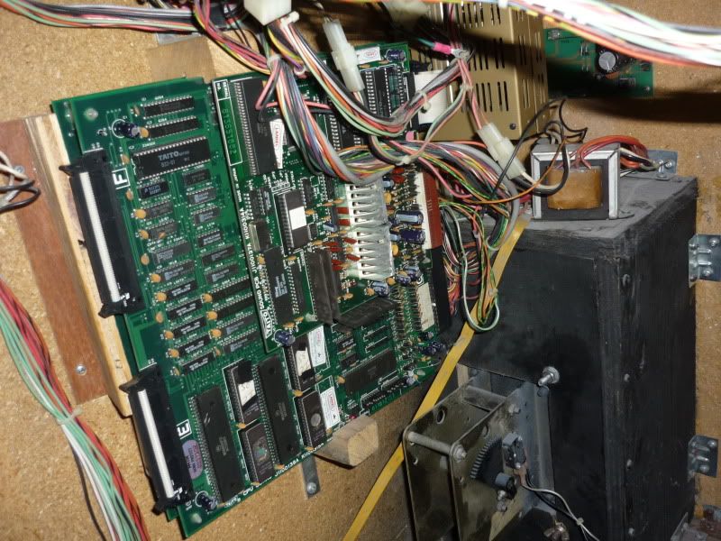

Silvereagle, can you please post a photo of your steering assembly so I can see if anything is missing? You said you thought I am missing a bracket that the spring connects to. Also, my PCB does not seem to have any mounts. It just rests on the slide-out tray. Can you please post photos showing how your boards are mounted? Mine is just sitting loose and I don't want to leave it that way. Thanks!

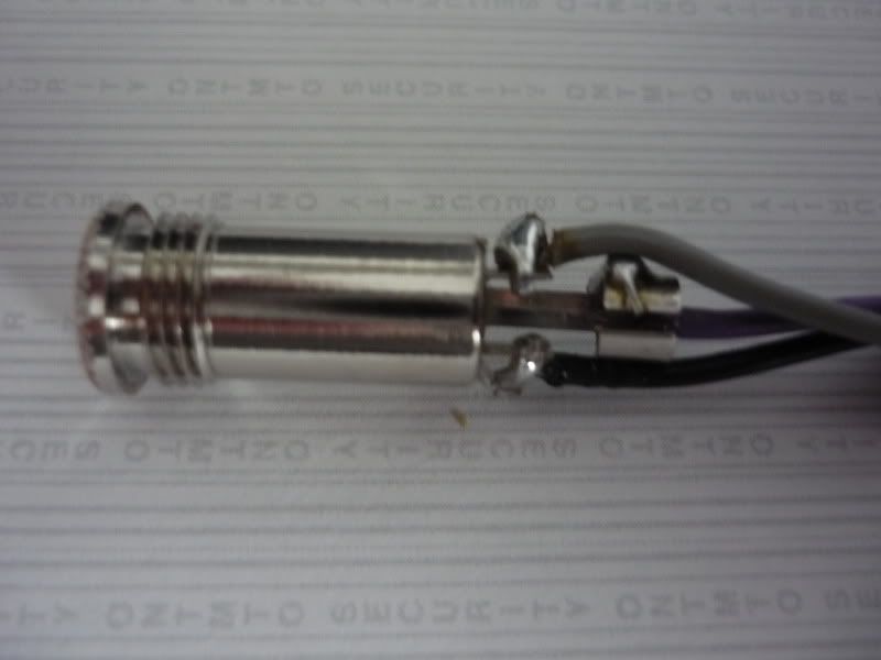

OK, I just got home and need to update this. First off the connector on the glasses:
The Tip is the right channel.
The Ring is the left channel.
The sleeve is the ground.
These are opposite of how a typical stereo headphone set is wired.
Next, the connector. From looking at the pic I assumed it was a .062 diameter connector. It is actually a .093 diameter connector. The correct parts to order are here:
http://www.mouser.com/ProductDetail/Molex/03-09-1031/?qs=sGAEpiMZZMtVoztFdqDXOya2qcujYnQn
Of course you will need to get the associated sockets as well.

SanTe, I have plenty of the springs you are looking for. Let me know if you can't find one locally and I'll ship you a spare and as far as the steering goes, try switching the dips from free to locked. You will notice a huge difference.
Just wanted to add I fixed my steering assembly this morning and combined with the locked steering dip switch, the game controls so much nicer. Best of all, the wheel returns to center when you let go of it, the way it was meant to :)
Thank you Oryk. I'm assuming you didn't cut the glasses plug to expose the 3 wires inside of it? I was planning on splicing mine open and hard wiring it to the pig tail connector i made. Good job though guys :)
No, I didn't cut the wire on the glasses, I just built the dongle making it easier to swap out the glasses later.
Oh I see. IS there anyway you can post a couple of photos of the "dongle" and how it was wired Oryk? Just wanna make sure I don't mess up my new glasses when they arrive. Initially I was going to cut the plug on the glasses off and hardwire it but I noticed there's an oval looking thing at the end of the glasses wiring so I am not sure if that is needed or not.
Silvereagle, can you please post a photo of your steering assembly so I can see if anything is missing? You said you thought I am missing a bracket that the spring connects to. Also, my PCB does not seem to have any mounts. It just rests on the slide-out tray. Can you please post photos showing how your boards are mounted? Mine is just sitting loose and I don't want to leave it that way. Thanks![/QUOTE]
SanTe,
My apologies for not filling your request sooner. I completely missed it and only seen it now after reading the thread again. Anyhow, here's the photos as you requested. As you can see, my cab's pcb, power supply etc are all mounted on the side of the cab which is dislike and plan to change but if you look closely, there are plywood boards that hold the pcb in place because it doesn't have feet to secure it to the wood. My Chase HQ is the exact same thing only the board is secured by the same pieces of plywood in the tray like your CC. TAITO had some weird designs back in the day.
