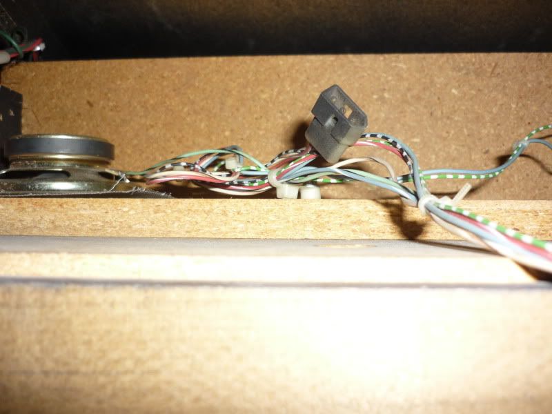

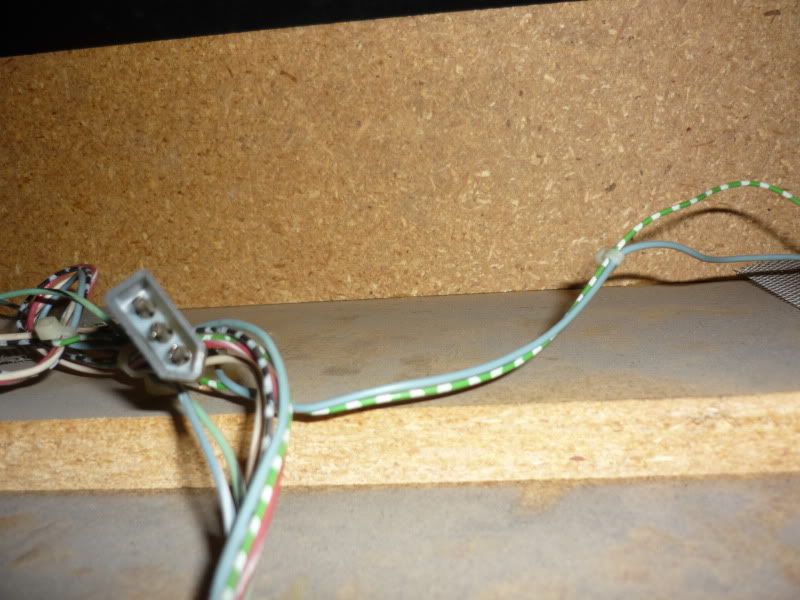

You should be able to splice the wiring, I am just building the adaptor because I feel it will be cleaner. Can you take a picture of the cabinet connector for me?
Ockey Dokey, here's a couple of pics:

OK, I know what that connector is. Can you tell me which wires go where? Either the actual signal or just the harness connector positions. There is an online pinout, I just don't have anything to match it to...
I thought I had the matching male connector I got from Bob Roberts a while back but looks like I got ganked. Might need to hard wired it in/ Do you know a place besides Bob where I can buy this connector Oryk?
As far as wiring goes, it shows B-W being Ground (probably black/white), Red-White being Lens Right and White-Brown being Lens Left, these being right on the connector pins themselves.
Hope that helps :)
I'd double-check a non-mall radio shack just to see, for some reason I think they have them.
If not I prob have a couple somewhere with some leads on em.
Yeah, I will check a local electronics store. (Sayal Electronics) I'm sure they have something. And Oryk, I am sure you will be testing the glasses way before me as I am still waiting for them but let me know how you make out :)
I don't think they have the 3 position connector like that, but Radio Shack does have a 4 position, which you could probably cut down to size ( http://www.radioshack.com/product/index.jsp?productId=2103250 )... or at least just crimp/heatshrink the pins individually, and then tape (until your next order when you can get the correct plastic housing).

Ended up finding the connector at Sayal so all I need now are the damn glasses.
