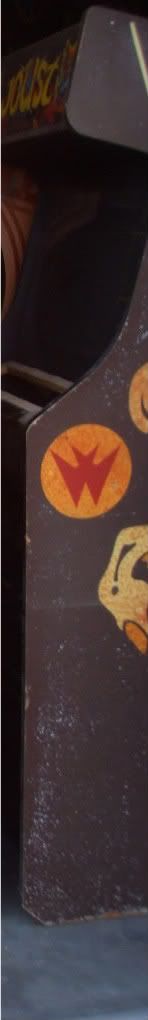

Thanks Greg, yeah the beauty of this one will be when it's all assembled. The marquee, bezel, cpo, coin doors, etc. add much needed flare to the earthy tones of the cabinet. Sometimes it's hard to see where you came from and where you went with it, so here are some quick before and after direct comparison shots for easier viewing:
Left side:
Right side:
