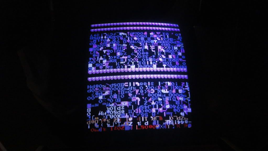

Eight Ball Action on a Donkey Kong Junior board:
Original Donkey Kong:
Donkey Kong Junior:
Any ideas??? All boards were tested in my wrking original Donkey Kong cab using original hook-ups so the problem is definitely something with the boards. From the looks of the issues, it is the same problem with every board.
Do you have a eprom burner? If you do read the Eproms and then save them. After you have saved them verify them in winromident. WinRomIdent will tell you which roms are bad. Sometimes I've seen that the 2114 ram has caused these issues too. Try piggybacking some 2114 ram and see if you notice a change. This would be a good place to start.
No I don't. I would like to get one eventually.
I don't usully deal with chassis/video inverters/audio boards, PCBs, and power supply rebuilds. How does one "piggyback" the RAM??? I know where to get the 2114 but is it something I will be needing my soldering iron for??? I am assuming so since the 2P chip is not socketed.
piggybacking refers to placing a good chip directly on top of a suspect chip where the legs are in contact with the legs of the other chip.Thus the term piggyback.There is no soldering involved unless the chips are bad. Pay attention to the Cpu board at locations 3A+3B and 4A+4B these are 2114 ram locations and go bad.
Good deal. Thank you for the information. I had figured to look at the 2114 RAM but wasn't sure. I don't have any chips on hand as I cannot solder so I guess I will have to wait to work on these, get someone to work on these, or sell them off as-is.

The first thing to check would be the sockets. Especially the CPU sockets...
Corrosion there is common and those single wipe sockets only make contact with the inner surface of the chip legs.
Also when you remove that kit you'll probably have to replace the CPU socket.

Totally agree, When I get a board doing anything like that the first thing I do is pull each chip and clean the legs with an eraser, then I use deoxIT on the pins and reinsert. I have fixed a few boards that way. The cheapest source of deoxIT is at Radio Shack part # 64-057 about $6. They sell deoxIT there too, but it is such a tiny can.

It is so easy, just use the applicator brush and "Paint" the cleaner on the pins, then reinsert in socket while still "wet" It will remove oxidation on the pins and the socket. I still pre-clean the pins with an eraser till they are for the most part not black (oxidized) any more.

Quit worrying about rust on pins that are soldered in place.
If the rust is bridging 2 pins then hit it with a stiff toothbrush to knock it off the chip.
The only way the rust would bother anything is if it's inhibiting contact in a socket, bridging pins (which is something I've never seen in all the repairs I've done) or if it travels up the leg inside the chip body... (which is something I've seen ONCE in all my repairs)
