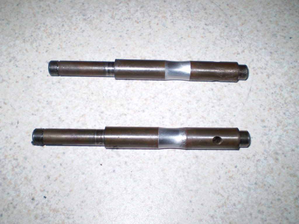

Picked up a Missile Command Upright and rebuilt the trackball. Parts purchased from Ram Controls. Pulled and replaced the shafts -

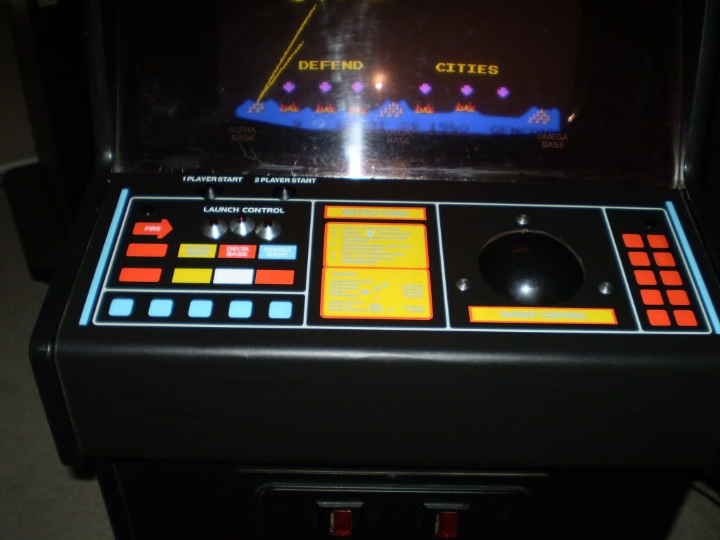

Replaced the CPO with an AS version -

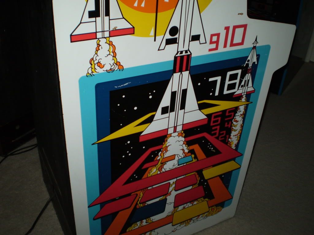

Few other shots - Original side art. It was in private ownership for 24 years. Still have some cleaning to do.

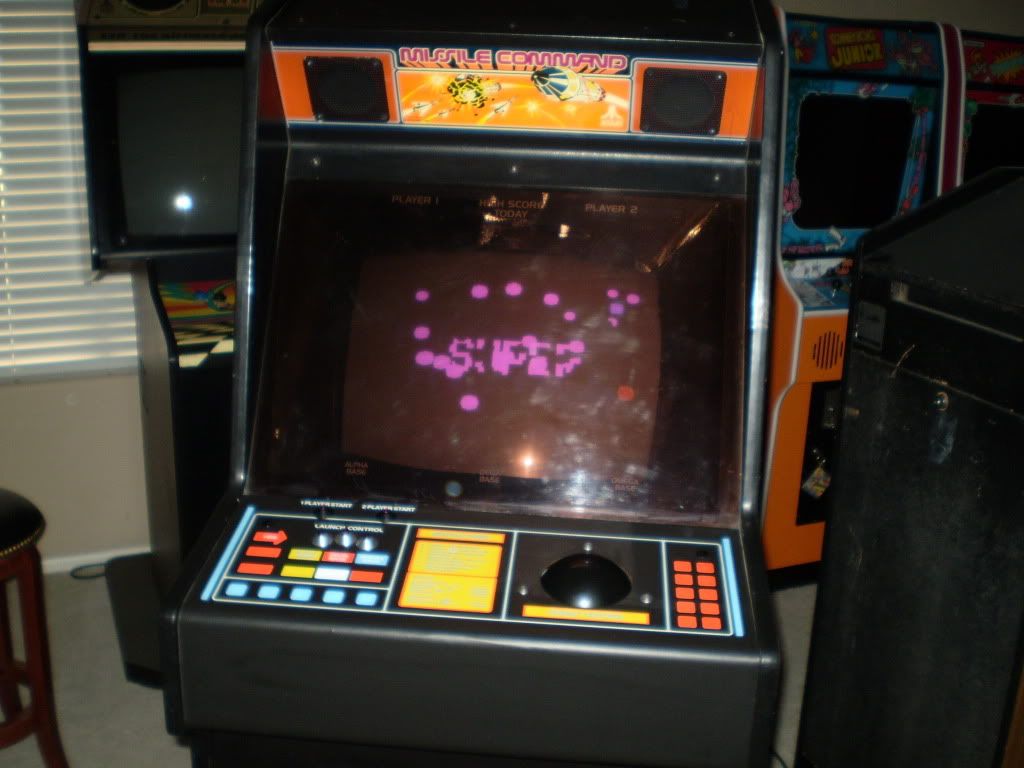

Installed the MC/SMC High Score save -
yep, lookin gooood!:cool:
yes, it amazed me as well how the shafts could get so worn down from the ball.
That;s why your post hit home the other day. Hate Super Missile Attack....love it more with a new trackball, still hate the game! Love the fresh oil on those bearings, still hate the game. Love the shiny new ball, still hate the game. Love the new CPO, still hate the game. ;)
