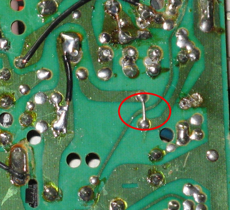

Where is C69 on a 25K7193. Either I am blind or I cannot find it. Is there dedicated pads that are silkscreened on the PCB, or is this capacitor piggybacking other pads? I may have read somewhere that it is piggybacking C36, but I may have misunderstood what I read.

There are pads and it is silkscreened on my PCB, but it is empty (C69). Instead it was jumpered over. My C36 is 6800pF.
I guess my original question still stands - how do you know if you need C36 or not? Is it required with certain flybacks?
Should I change my C36 to be the more traditional 6100 or 6200pF?

It depends on whether your C38 is 4-legged or 2-legged. 2-legged usually have C69 with it somewhere, but you'll sometimes have to remove it after a rebuild that includes a new flyback in order to get it to work...

Ok, I need help. My 7193 has a C69 silkscreened on the board, but the previous owner didn't populate it and instead put 6800pf on C36. C36 on this board is silkscreened as the 2 leg type.
In this situation, how should C69 be jumpered to remove it? Or no jumpers, just leave the silkscreened location empty?

OK i need pics to see what the underside of your chassis looks like.
in my experience if the chassis had a C36 and a C69 then you need both independently on the board not tied together.
if they are tied together it will not work. this was a later design from what i have seen.
and if you do need a C69 the value is .0036uf/1600v
and C36 is the standard value of .0061uf/1600v
and check R103 if it is out of tolerance by more than .5-.7% the chassis will stay in HV shutdown.

Thanks for your response Buffett. Here is a photo of underside:
Ok - here's the weird thing. The guy who did this previously added a jumper from the ground of C36 and connecting it to C37 and D15 (where C69 was supposed to connect). The result is that many areas around this spot is now grounded. See the attached picture, I circled the jumper

Thanks, I'll take a look at it. I am not getting HV shutdown but my KV output at the cup is varying a few KV and is getting over 27KV (which I believe is near shutdown level). The reason I am looking at this is because I am getting blooming (hopefully related to my KV not being stable) and my raster not centered. The raster position jumper is next to C69, so hopefully removing that odd ground connection fixes this problem.

that chassis looks to have used the old 4 legged C36. a 2 legged cap will work with the jumper. but you will need to undo the other mods that were done.
my suspicion is that he added in the bigger cap because:
A: that is all he could find.
B: adding the extra value to C36 would compensate for the lack of not having C37.
so if i am correct you will need C37 and the diode that goes there to undo the previous mod.

From the back it looks like a 4 legged C36. But on the front it has 2 leg C36 and 2 leg C69 on the silkscreen drawings.
If you think it's reason A (owner didn't have parts to full repair it), then should I just change C36 to 3600pf and add C69 at 6100pf? Is there any reason to not do this?

I have a C37 and D15. If it doesn't look like I have them in the previous pictures is because I pulled the legs on one side to test them.
It was after I pulled C37 and D15 that I noticed the jumper I pictured in my previous post is grounding C37 and D15.

only use 1 cap at C36 .0061uf/1600v and jumper the pads.

Back from work, so I can look at this in more detail. What's listed above won't work on boards with C69. In fact I am pretty sure that the last guy who worked on this chassis did the above jumpers on my board without thinking (see PCB picture in above post with red circle highlighting the jumper mod).
Here's a very blurry picture of the top side showing C36 and C69. C36 is populated (the big red one), C69 is not populated (you can see the empty position behind C36):
The reason is why Bob's jumpers won't work, is because this is what it does on my board (orange and red wires are his jumpers):
As you can see, I don't need to do one of the jumpers (red) because this board already has a PCB trace to connect the collector of HOT to both C36 and C69. I can't do the other trace (orange) because it connects several points to ground.
What do you guys do when you cap these boards? Do you replace both C36 (3600pf) and C69 (6100pf), do you remove C69 and use 6100pf for C36, or do you leave them alone?

if in fact that you need both.
then that model will not work with the mod.
i would populate it with both caps and undo the jumper that is in there now and see what you get.
i have never had to replace either cap on the models that required both caps.
but i am sure i will in the future so i guess i better stock a few of the other C69 caps.

Doing the modification Bob Roberts shows on a board that does have a C69 screened but only using a C38 will work. I know I've done it before...

gamefixer also implied that you can do the Bob Roberts jumper on C36/C69 boards with 19" chassis but not 25".
Going to order a C69 to repopulate the missing part.
Yeah, I had a hell of a time with two chassis that some one else worked on. By the time I got them they were dead. I un did the mod, put the right caps on the board (bought the caps from Wells) and they both came to life. While they were jumpered "wrong" they didnt blow anything up or pop any fuses which added to me being perplexed at the time.
