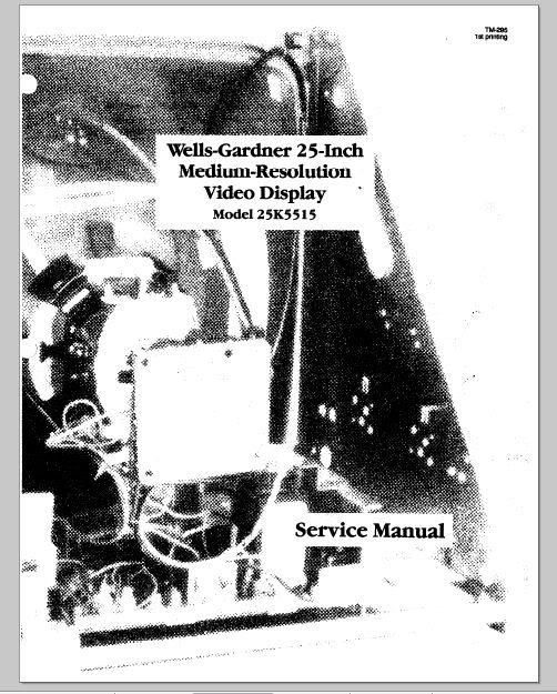

According to The manual for the K7000 series, on page 2 it lists the resolution of the 25" monitor as 560x240. That's certainly medium resolution, I'm just not sure if it's a comparable resolution to the K5515 (which doesn't seem to mention a resolution in it's manual)
Really?

What's pixel count have to do with this argument ?
CGA (standard) can run in the neighborhood of 640x200.
Standard resolution runs at 15khz, medium is at 25khz...... that's where the huge difference comes into play.
The pixel ratio is only a piece of the puzzle, the frequency at which they run is where they are different.
The K7000's are standard resolution, the K5515 is a medium resolution.
720 outputs medium resolution frequencies, regardless of pixel ratio.
