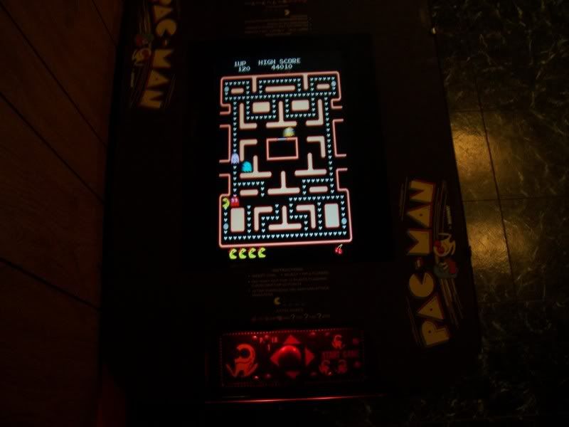

Has anybody done this, and were there any compatability issues? What LCD TV/Monitor do you use in yours? (brand/exact size) Does the widescreen look weird? Got pics of your games screenshot? I personally could care less about how close it looks to the old monitors. I just don't want to buy a TV or a LCD monitor, and then find out that it won't work with my 60 in 1, or doesn't fit the screen right. Anybody?

As long as the monitor/tv will accept a resolution of 640x480 it should be fine. Most monitors have an auto adjust, do it when in a game like pacman or donkeykong, the menu is smaller and if you adjust to that some games will be off the edge of the screen. I think once you go past 19" there are only widescreen LCDs. I would look for one that has the option of keeping the 4x3 ratio OR streching the image. My Dell 20" (or 22") has that option as well as all HD tv's Ive used. Don't know of a 25" LCD though, they do have 26" and if you are going to be using the 4x3 ratio, you won't be using all of it.
I replaced a bad G07 in my pacman cocktail with a 19" dell widescreen lcd put in sideways. I have the 48-1 board, in the test mode there is an option to rotate 90 degrees so it is using the monitor vertically instead of horizontally. The picture is real nice. I think horizontally the old games would look strange being wide. I will snap a pic of it this weekend for you.

First, buy a computer monitor and not a TV since they are cheaper. Also, you can still buy non-widescreen computer displays. Newegg.com has about 40+ of them, but I think the largest is about 22".
If you want to have a 25" 4:3 screen you would need to buy like a 30" 16x9 monitor and do not allow it to stretch.
If you buy a computer monitor they are not typically 16x9 more like 16x10 so maybe a 28-29 might give about the right size of a 25" crt
I was able to fine some dimensions 26.4"x 19.2" for a 28" LCD, it would be a close fit depending on the cabinet you want to mount it in.

I frequently use a 25" LCD to test out my 60 in 1 boards, which is why it would be nice of there was a 90' flip.
I am saying the screen is wide vertically instead of horizontally and that be a screen rotated 90 degrees not 180.
What he means is that the games are "vertically oriented", not "horizontally oriented", and that the monitor must be turned 90 degrees if it's normally mounted horizontally...
