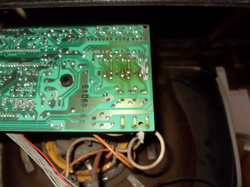

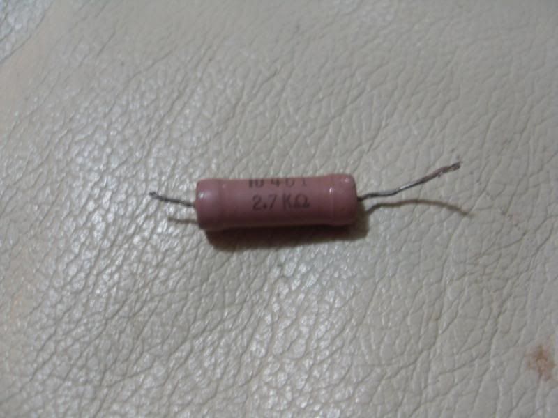

Well I just got a Die Hard and it works but Monitor has no blue and adjusting pots doesn't add it,you can see where some one tried to fix some traces on the board that connects to the tube, what is that called and can you just buy them instead of the whole chassis, the pic below is a component from the board right underneath the blue pot and it was getting very very hot compared to the other 2 for green and red, anyone have a clue, thanks
Those monitors are famous for bad solder/traces there on the neckboard. they didn't use big enough heat sinks on those color transistors. You can continue to fix it with jumpers, or you can try to get a new neckboard. I'd check with Chad at arcadecup if you want to go the replacement route...

Check components around blue drive and compare to red and green parts to see if a bad resistor,transistor is bad.
the transistor with the hacked traces and shit is in fact the blue one.
if any one of those legs on the transistor isn't making contact, OR the resistor is bad, you will be missing blue. :)
ways to diagnose whether the transistor/resistor's bad or not, you desolder the suspect one and switch it with a known good one. if the problem carries, you have bad parts... if the problem stays the same, then the parts are good, but the solder joints aren't making contact. if they all work, then that's fantastic.
is this a K7500 or U5000 by chance? I have some extra neckboards, but I think they all have lifting pads on them.
does anyone here know if you can superglue the underside of the pads back on and then be able to resolder again fine?

i just tried to fix the traces and swap out the component pictured above with a known working one and no luck getting my blue back
well in replaced the neckboard(thanks to mecha187) and still no blue, what can i check on the chassis?
ah yes, reflow all the pins on the video connector header.
if that doesn't do anything then it's probably a tube problem, unless you ruled out that it's the transistor and resistors.
you inserted that one stray tiny black transistor in the new neck didn't you? make sure whatever is missing on the new neck you bring over from the old one.
ironically, I think that missing black transistor was for the blue.
Yeah I swapped everything over, its exactly same model neck board too, ill try the header pins tonight
