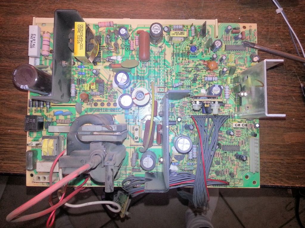

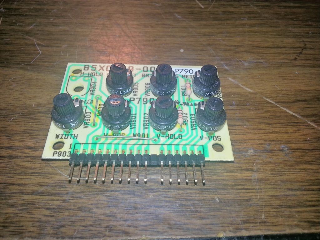

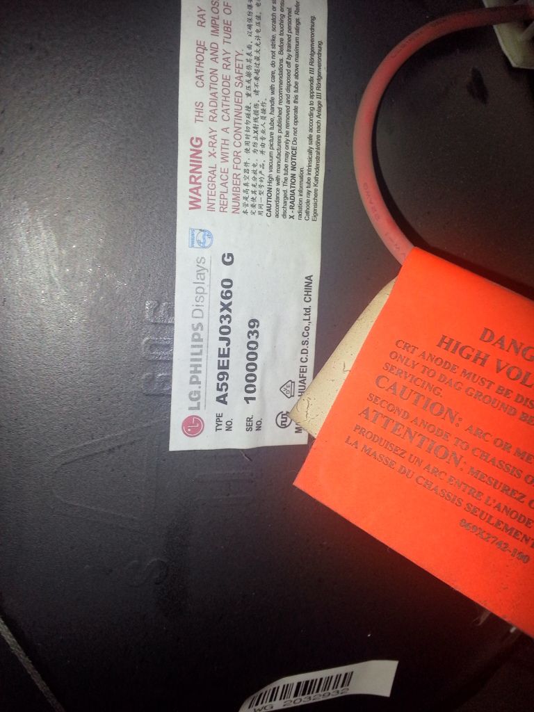

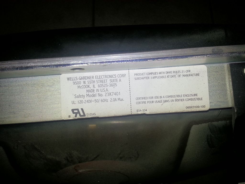

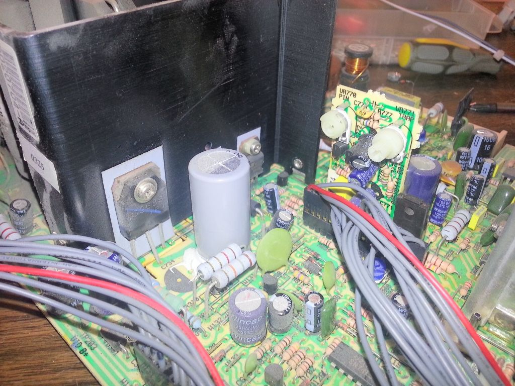

Had a customer bring in a K7400 for rebuild. I brought it home to do, and noticed something strange. A 23" K7400? Nothing on WG's site mentions the possibility, with all references being to either the 25" or 27". Tube measures 23" per viewable area. Curiously, it has the pincushion board installed.
But check out the pics:
I'll let y'all know if there is any discrepancy of the cap kit, and will compare it to a 25" K7400 to see if there are any other differences...
Cap Kit List was the same as the larger models.

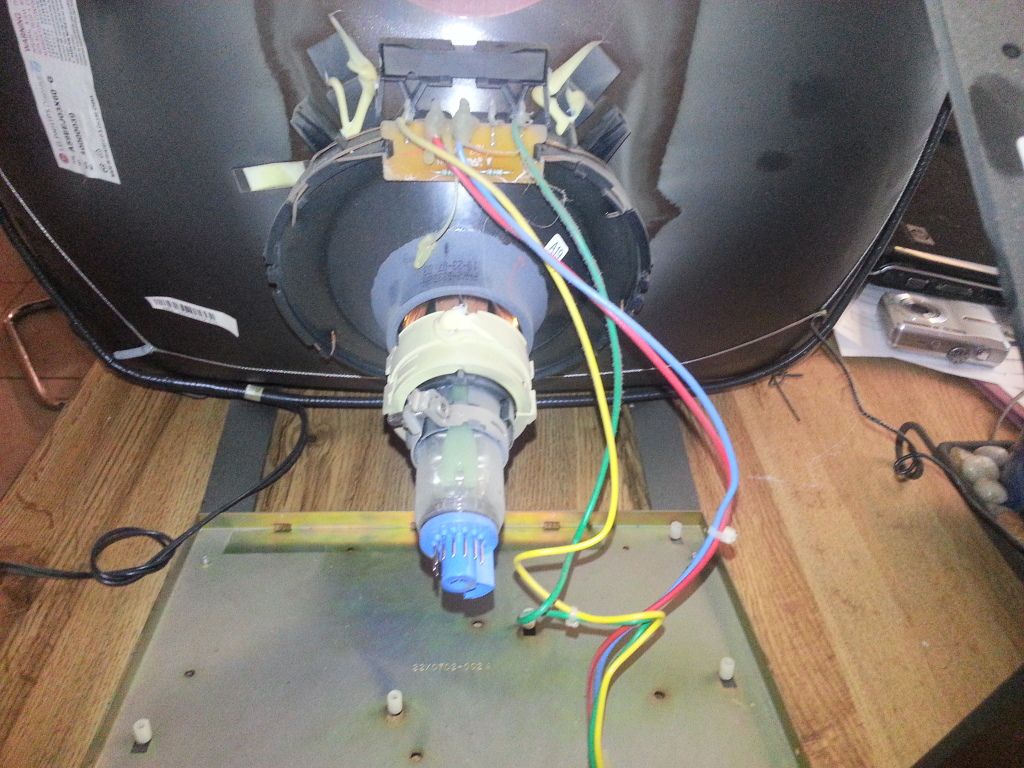

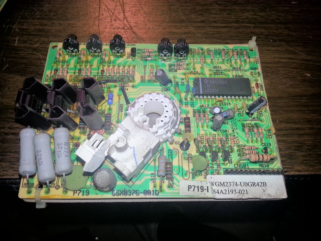

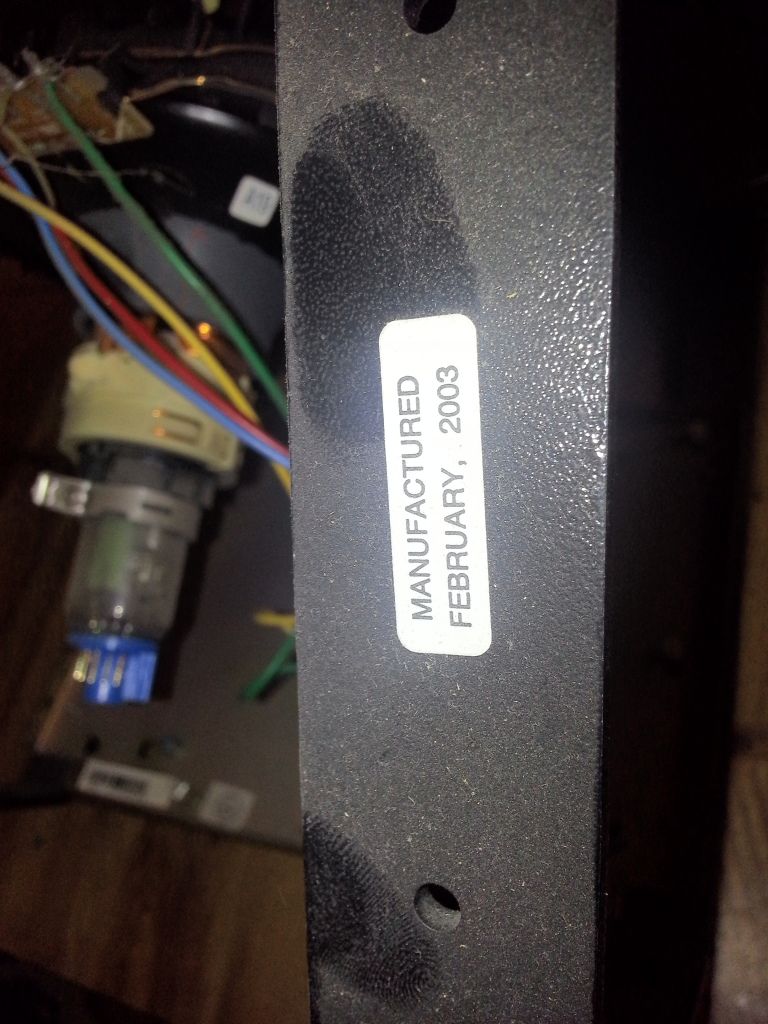

Here are some more pics before the rebuild:

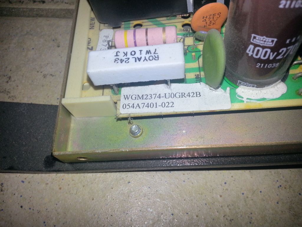

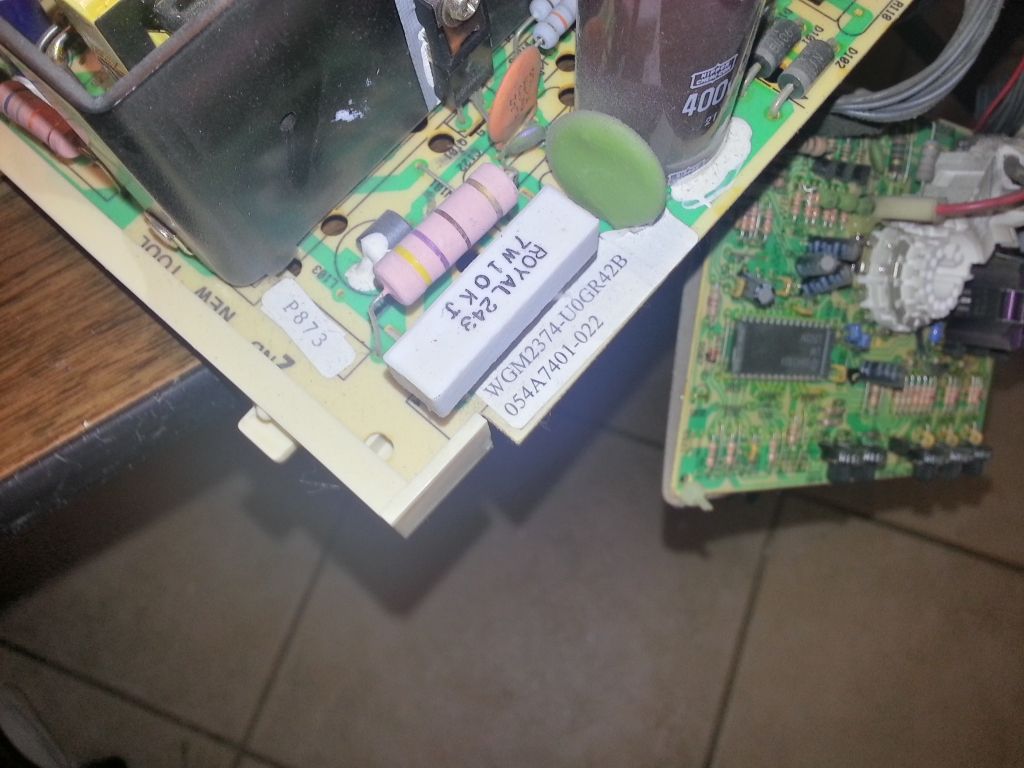

Notice that it is a P873, instead of the P763 you normally see on K7400's:
Also notice it has the newer flyback version for this model, rather than the original 053X0651-001:
Neckboard:
Remote:
In case anyone cares, he said it came from a Sammy Sports Shooting USA, so who knows what the original cab was...

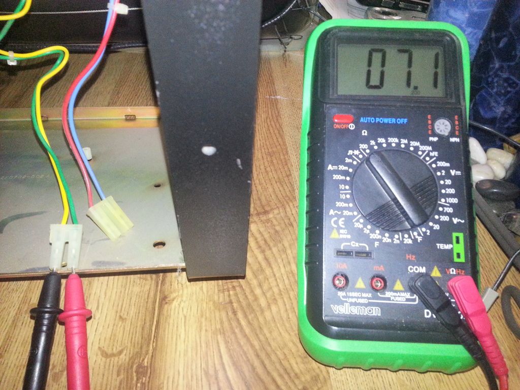

More pics. Here's the yoke:
Can anyone read that number?
Horizontal reading:
Vertical reading:
looks like the sharp image yoke standard rez. i wonder if it is the same guy. thanks for the log.
Weird looking yoke.....and it that frame powder coated black? Never seen that, either.
