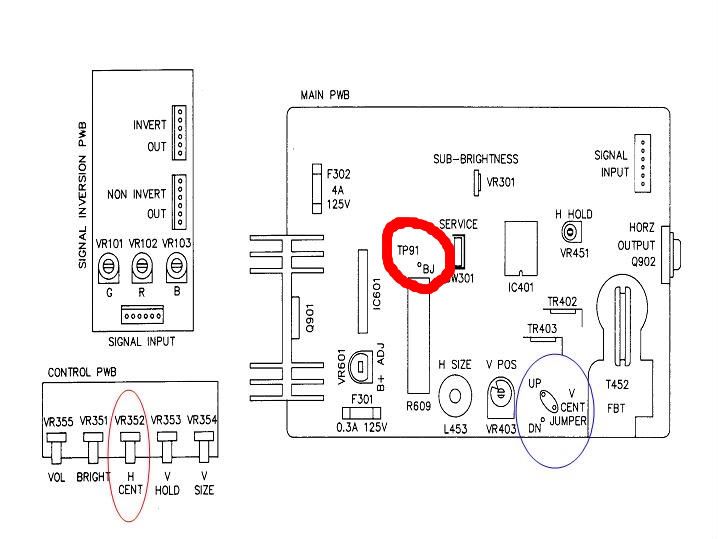

FrizzleFried Well-known member Donor 2011 VAPS Joined Mar 20, 2007 Messages 54,193 Reaction score 5,245 Location NAMPA, Idaho Feb 19, 2010 #1 My search-fu is weak... very weak... can someone tell me where the test points are on a 20EZ to measure B+ voltage? A photo would even be best as I am not all too bright... and seeing the purdy photos helps a lot. Thank you!
KevinMullins Active member Joined May 27, 2009 Messages 2,187 Reaction score 10 Location Mcloud, Oklahoma Feb 19, 2010 #2 It's the BJ terminal right behind the LARGE resistor. You can actually just measure off that back leg of the same resistor too. http://www.youtube.com/watch?v=2LqmDMEI1fI
