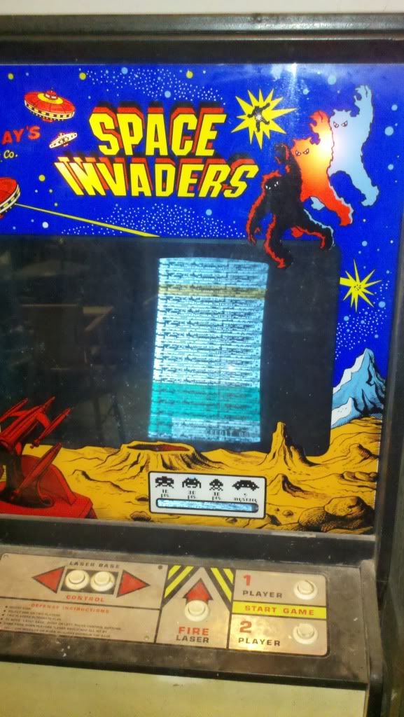

Space Invaders shows the following on the screen:

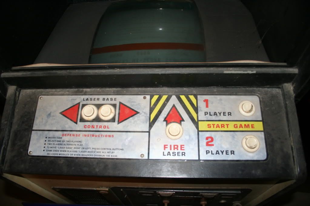

Control panel is in suprisingly good condition. Once I clean it up I'll determine if I will replace it or not

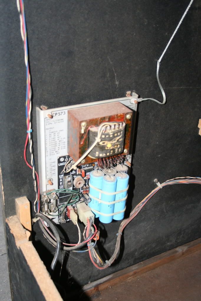

Here is what I get on the monitor
I'll be starting by checking out the voltages.

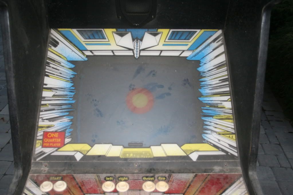

On to the Star Castle

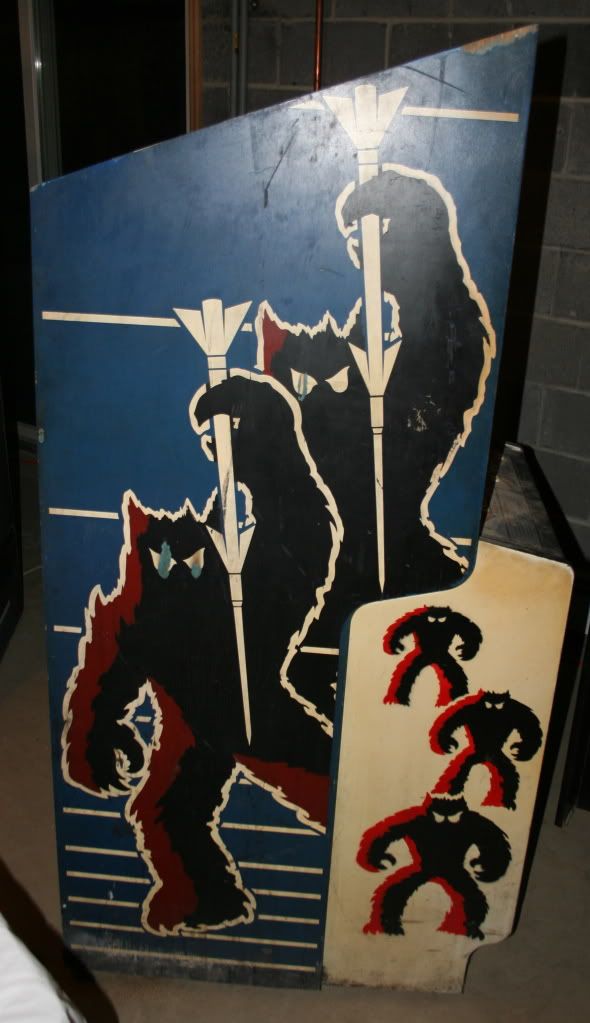

Side art is in decent shape, but up close looks to be bubbling in spots

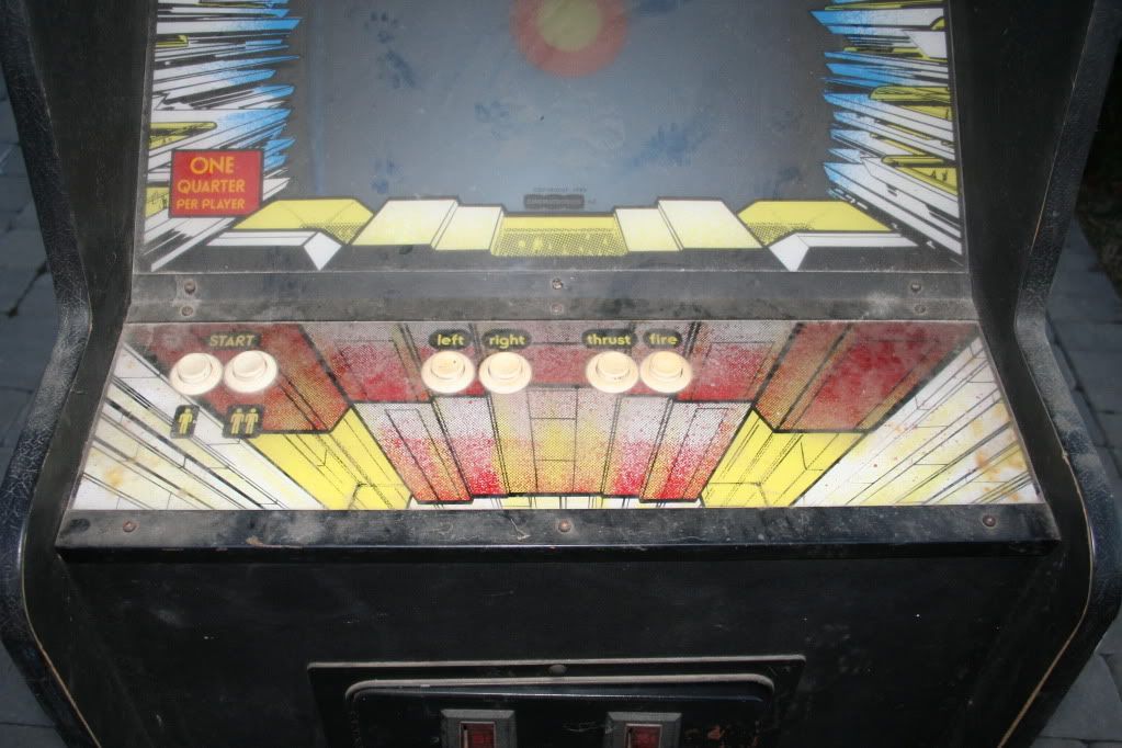

Control panel
Bezel

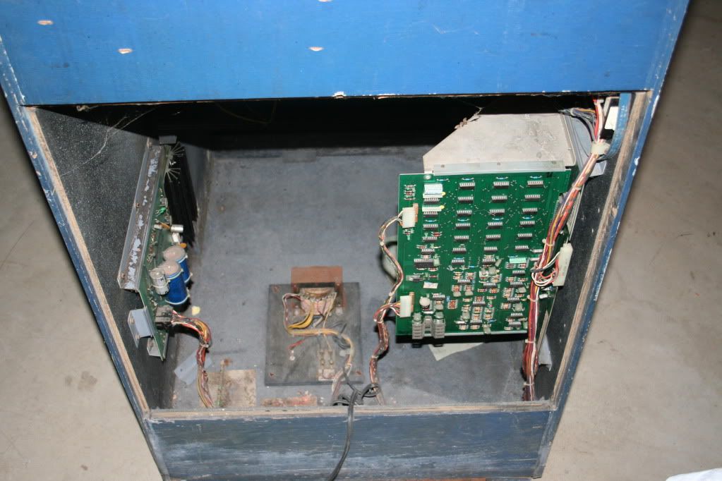

The bad part is the bottom front of the cab. I haven't look closely to see how big an issue this is
More Star Castle
Game powered up and played blind for a few minutes with this on the screen
After a few minutes there was a pop and nothing. No sound, no game play, and no vertical line on the monitor.

On your SI, check the connector to the power supply. A lot of times, the pins back out of the connector and don't make good connection. if you get a missing voltage or ground, you get that picture...
