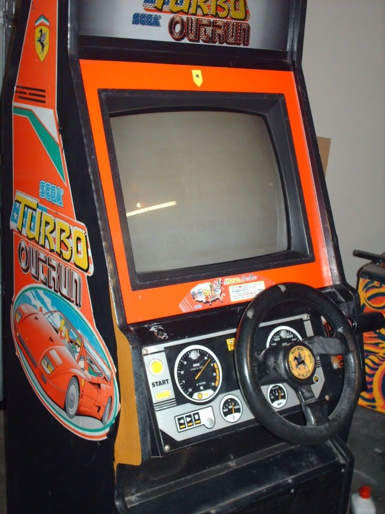

I've been on the hunt for a Turbo Outrun for years and my wish finally came true earlier today. I got it non-working but a few reseated cables have brought her back to life. I was amazed to see my old arcade favorite...I haven't been in front of a real one since I was twelve.
I do not have sound and I've tried all of the common things. Often no sound is caused by a bad fuse in the bottom of the cab, I found the sound fuse, but it metered okay. I pulled all fuse QDs and reseated. I pulled apart the two board stack, pressed on all socketed chips, and reseated all cables. No sound at all. Could I have a bad sound pot? Any way to check? Take a look at the picture, am I missing a board? There are a lot of unused connectors in the bottom of the cabinet.
The expensive gears used for steering are okay. I don't think Turbo Outrun ever had a shaker motor. I have one side of art, and one side painted black. One side is better than nothing! The monitor is a K7000 with an original white knob flyback in need of a cap kit. The red monitor plexi is gone and I'm left with a plain replacement. The steering wheel cap is also gone.
there is no sound beacuse someone removed the audio amp board out of it.
those 3 connectors behind the power supply are for the audio amp. If you need one, I have one.

That looks like what I'm missing. I've heard that the amp board is game specific...ie the mini version has a different pinout than the sitdown version. But hey, if you got this from a mini, then I should be good either way.
I have a bunch of sega system16 boards so I know all about the battery backed up FD CPU. It's no problem, a $40 kit will get this fixed up. It is working right now, so getting the sound up is going to be my top priority (and first purchase). Next will be a monitor cap kit.
