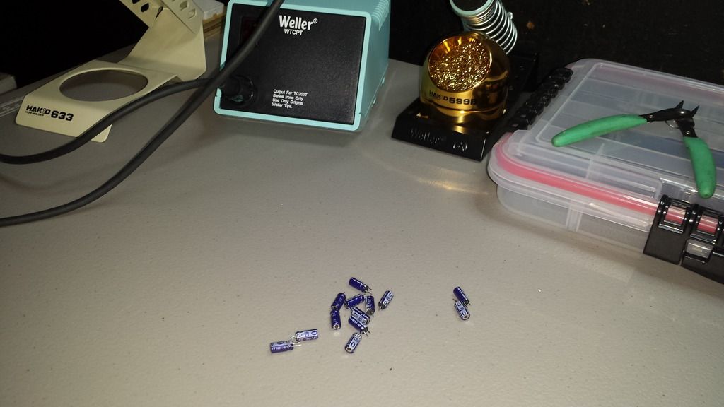

Guys... I know its not a big deal to most but I just finished capping the sound portion of my ZAXXON PCB replacing thirteen 2.2uF 50v capacitors and all the sounds came back perfectly. I took my time and completed it in about an hour. I feel pretty awesome right now. Thank you to everyone who has helped me along the way with advice you guys are the best. Next for the Zaxxon will be the monitors cap kit. I just have to muster up the courage for it... LOL
