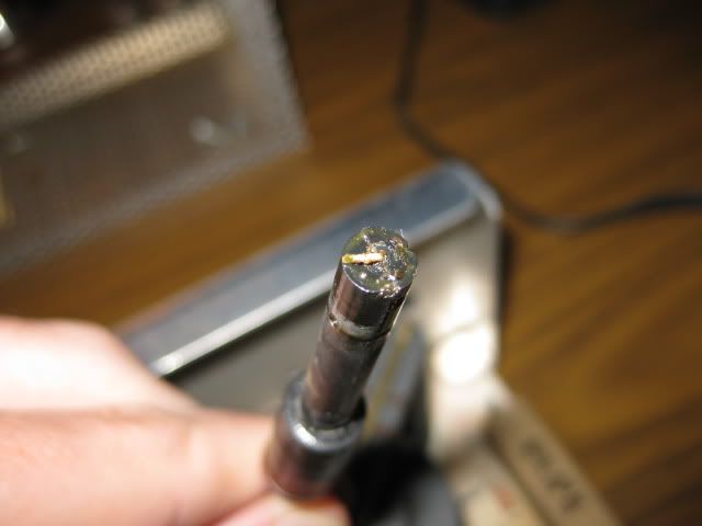

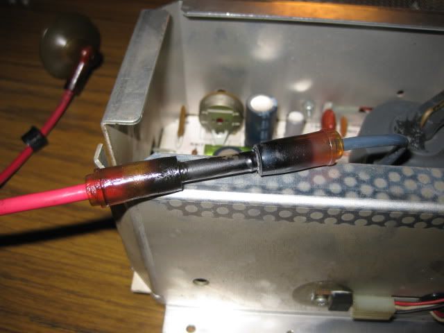

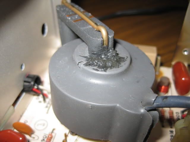

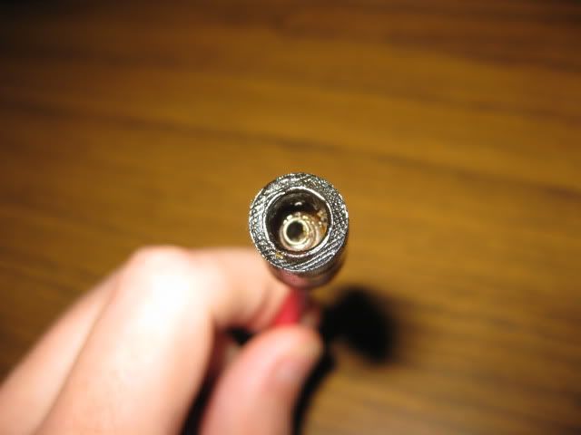

Got some pictures.
Here's the HV transformer, is that leakage at the top?
Here's where the line came apart.
This is what the end with the anode cup on it looks like.
This is the end that is attached to the HV transformer.
I can push both ends back together, but this is as far as they go. It doesn't seem snug at all.

First picture looks fine, just some silicone. Should be good.
The last 3 pictures are normal as well, that's the HV diode in there. The 3rd picture is actually the end of the diode (see that little nub of a lead?).. That's supposed to come apart. It SHOULD be a little snuggish though... I mean, it shouldn't just fall apart or anything.
Looks pretty normal to me.
That's a relief. The pcb actually has little clips in it to hold the line, so I guess maybe those keep it together. So I just slide it back on there and it's fine?
