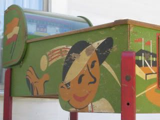

I'm new here so please bear with me! How do you access the playing field of the machine? The glass is stuck and I don't see how to get to the field. Help!! Here's a pic of the machine
We have one of these in the shop right now. Open the coin door, then reach up underneath and feel for the screws/wing nuts holding the control panel on. Once they're off, you can lift it up and trace the wiring for the controls back to a connector to unplug. Once it's off, you can slide the glass out, then lift the playfield up in the front like a car hood....
