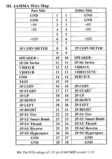

From what I've found, all the versions have the same pinout for 6 buttons. You're suggesting the harness doesn't have the wiring for those extra 2 buttons. So - just buy a fully loaded harness...
Excellent.com has the button info right in the details of each card. If you look at the two versions side by side they are different. The contacts for buttons 5 and 6 on a "B" board don't have any traces going to them where the "A" board does. However the manual that comes with all three cards states there are 6 buttons.

Ok. So on the "B" board, where are 1 player S5 and S6 buttons wired to on the pcb ?
I am having this exact issue....
Dave
The new "B" versions no longer have that problem.
As for the pinout:
