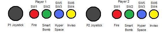

Not sure what I'm doing wrong here, I cannot get buttons 5 & 6 to work.
I've tried 2 different boards and 2 sets of jamma harnesses and still nothing. I've looked at the menu and didn't see anything to enable them.
Am I missing something?

pin 11 is inviso ,pin 26 is hyperspace ,those 2 are not used in most jamma cabinet ,if you plug in a standard jamma cabinet ,you will need to add those 2 wires .
Yeah I did add pin 11 and 26 and nothing, even tried a different jamma harness to double check and nothing, same problem on both boards. That why I was thinking I may have to turn on a dip switch to activate those 2 bottons or something in the menu, but I'm guessing not.
Has anyone with one of these boards have a button 5 & 6 hooked up and working?

If you plan on playing all the games with 2-players in mind, including without swapping panels, the control panel has to be set-up like a Neo Geo; each player gets a joy and 4 buttons. Omit Defender/Startgate and you only need 2 buttons per player, I believe.
I've got 2 joystick and 4 buttons (each side) on my cp:
b1 - fire (pin22)
b2 - Smart Bomb (pin23)
b3 - Hyperspace (pin26)
b4 - Inviso (pin11)
But for some reason hyperspace and inviso are not working on my 2 boards.
Can both boards have the same exact problem ???

I just try it in a test cabinet ,# 5 ,#6 buttons both work in my board .
It is 19-1 A board ,maybe the first gen 19-1 B board has problem or only your board ?
I use a jamma test cabinet ,add wires in #11 pin and #26 pin ,joysticks and all 6 buttons work ,I do not know how well it will play Defender ,Stargate but #5,#6 buttons are working for sure in my 19-1 .

Your board look like it was a 60-1 ,got reprogram to 19-1 ,I am just guessing since 19-1 should have label "BAR" on them " ICD" is for a 60-1 board .

Al observar los hilos del PCb los pines #11 y #26 no se conectan a nada. Es simplemente una estafa.
Es una placa 60 in 1 pero con el software cambiado.
