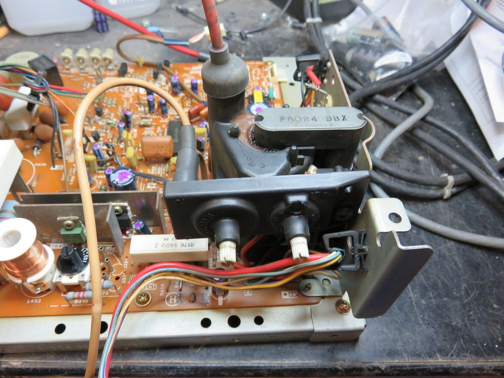

Is there a replacement available? I can't seem to locate any, does anyone know if these are even reproduced?
Thanks in advance!!

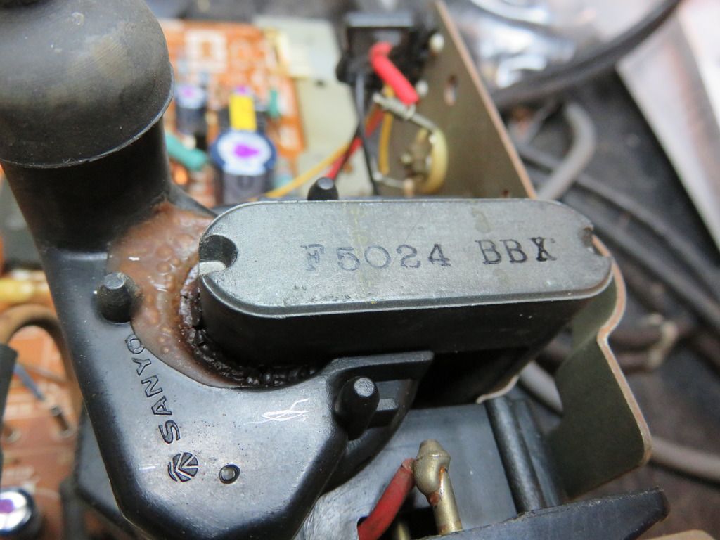

I think there are a couple different sanyo 14" chassis. I can't remember which is which, but 1 of them the 20ez fly works on. The other is completely different. I had to find a donor chassis to steal a fly from. - Barry
For the Sanyo 14" EZZ-C it's the F5O24BBX, and yea - having a problem finding a replacement.
i had one at my office that was F5024 ABB out of the same monitor and i checked with 4 factories in china i use and none of them have ever made this flyback. (i had a customer that wanted 5 of them so i just heard back this morning from the last factory). one thing i do wonder is why the last three letters are different on the same chassis? i have seen 4 of this same chassis and all with different letters at the end.

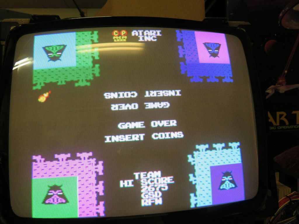

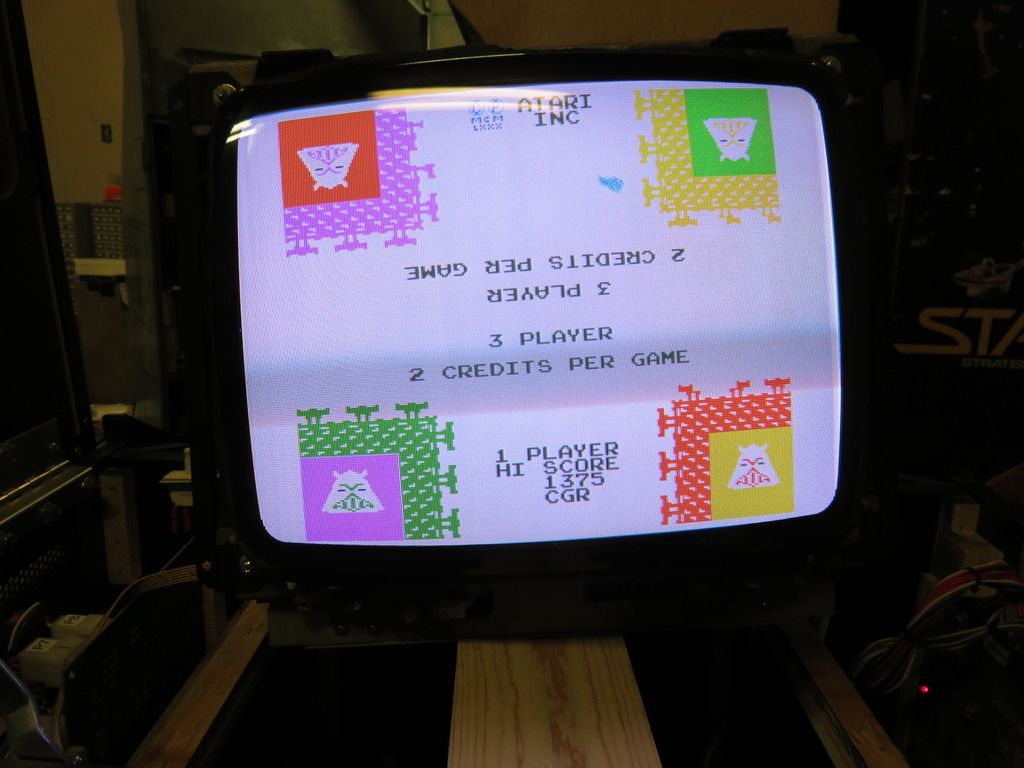

Did some talking here with some other guys and unlike a typical G07 recap, with the Sanyo's it's really not necessary to replace the flyback when running it.

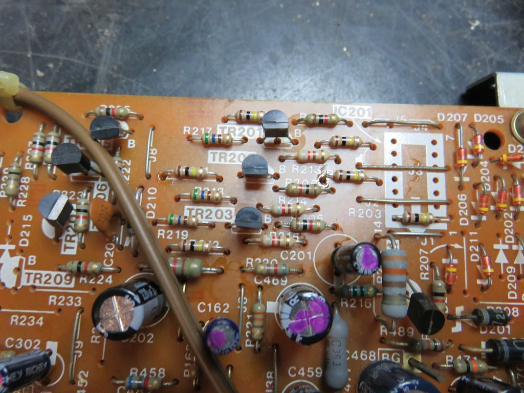

I took their word for it and left well enough alone. I did however have to run the BR positive video kit.
