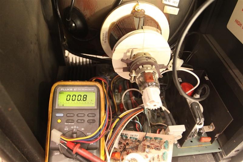

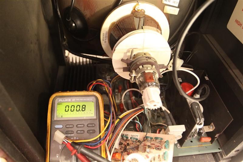

Is there anyone on the forum who currently owns a PAT9000 vector tube?
I was after a little info if possible please :) (Crucial to the repro project)
Please let me know if so.
Thank you
What do you need to know?
The original tube is a 13VBSP22
I am trying to gather info on the Deflection yoke if possible please
Any info is good info.
A clear pic of the yoke would be great. So I can count the windings
Wire gauge of the outer coil would be fantastic, with a micrometer etc.
Ohms Readings would help, IE outer coil, and inner coil etc
Inductance would be good too
A clear pic would be great if you can help. Anything else is a bonus

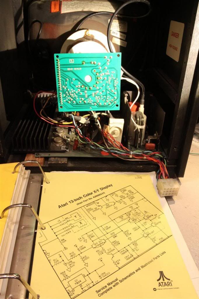

Click the pics for huge res.
Not that you need it, but the yoke schematic is on the front page of the manual, useful for the following two pics.
My Fluke 87 reads .4 ohm with the leads shorted, so no idea on how accurate this is. I sold my Sencore LC102 long ago and the 87 cannot measure inductance, so I can be of no help there..
